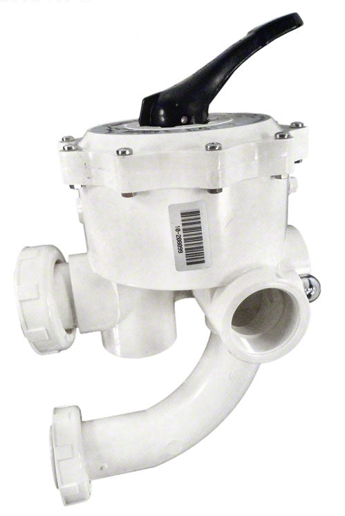

Looking at the DE filter - it seems ok, if it is I will likely keep it for now however will update to a MPV - any recommendations on a reasonable replacement?
The old ball valves have never been used / moved in the 8 years I've been in the house, are they really worth replacing with Jandy 2 port valves (they are $50+ each) or just remove and replace piping without valves?

You should use the Pentair MPV that matches your FNS filter....

My local pool store seems to be out of everything. No acid, no liquid chlorine,, luckily they did have lots of DE. I got my multiport valve off ebay for an ok price. Received it in 2 days. DE filter was estimated at 8 days, got in 6 days. 2 inch PCV fittings was a pain. Had to visit 3 different stores to get five 90 degree elbows. Didn't see any 45 deg elbows or couplers.
