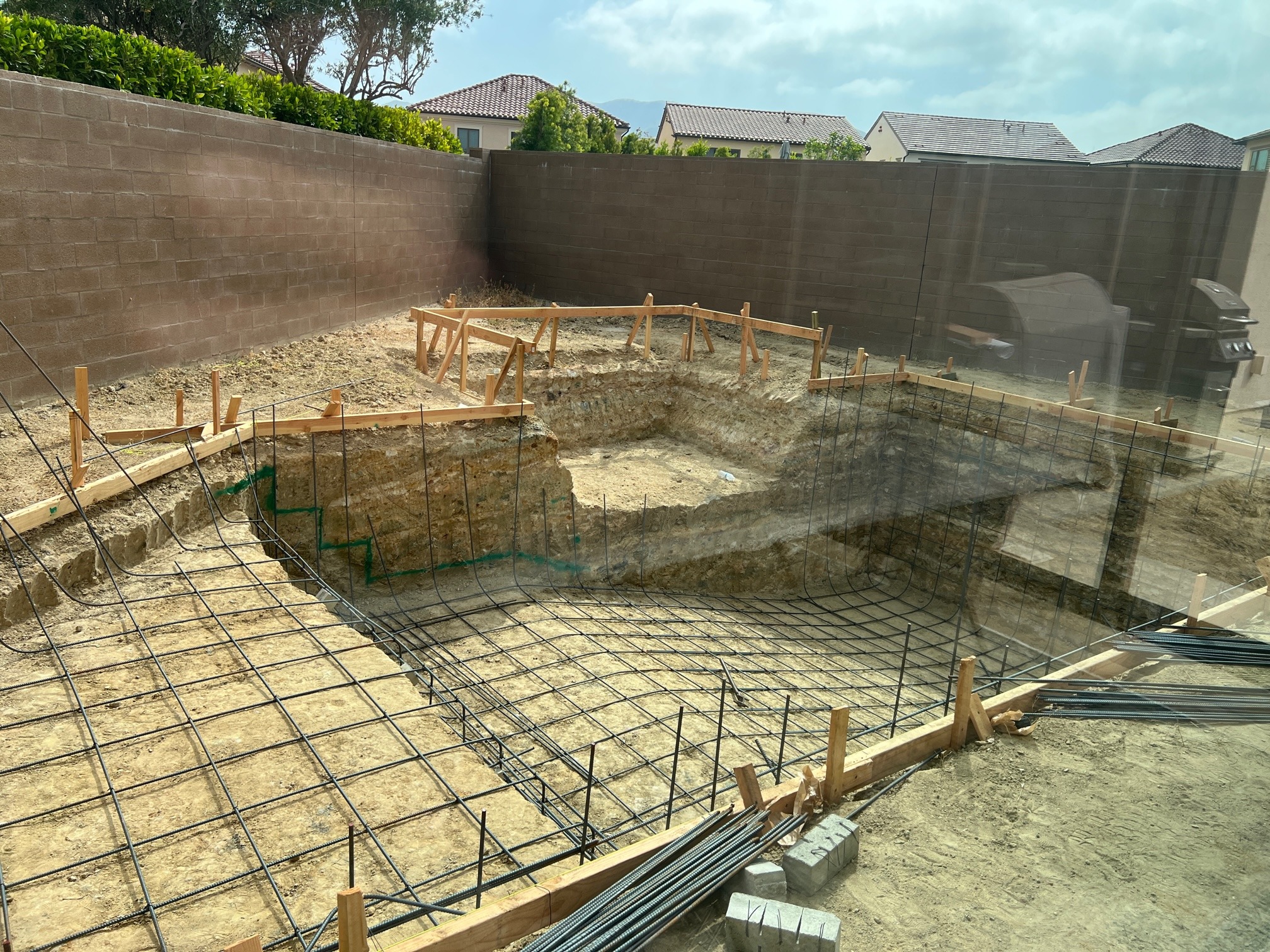

First, I'd like to thank all the members on TFP for all the info that helped me get to where I am today.
Luckily, I am only 3 weeks into the new pool build and we've made really good progress.
I'm still undecided on the finishing details but here are a few photos of the last 3 weeks!
Here are some specs for my build:
Pentair 3HP Intelliflo Variable Speed Pump for Pool and Spa
Pentair 2.2THP Superflow Variable Speed Pump for 3 Bubblers
Pentair 400K BTU Mastertemp Lo-Nox Heater HD
Pentair 48SQF FNS Plus DE Filter with Push/Pull valve
Pentair Easytouch Control with IC40 SCG
Pentair Color Sync Controller
Pentair Screenlogic Bundle
Pentair Globrite Color LED and Niche Kit - 4 for Pool, 2 for Spa. 3 for Bubblers
