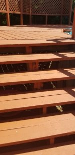

Just an update to close this off... I finished a couple of weeks ago and it is a tremendous improvement over my half hearted restaining efforts of the past. I used the textured stuff and it has significantly reduced how slippery it is when wet, which is another nuisance I had been trying to solve for years. The proof will be in how it lasts over time of course, but it feels really durable. This stuff was like molasses in terms of thickness, not like anything I've worked w before, but was still pretty manageable.

Awesome work Paul !!! I think your larger gaps will help a good deal. A neighbor redid his a few years back with similar textured stuff (pretty sure it was Behr), but his boards were swollen a lot closer. The stuff kind of pooled in the cracks and broke free in a year or so leaving him with ugly bare pinstripes.
