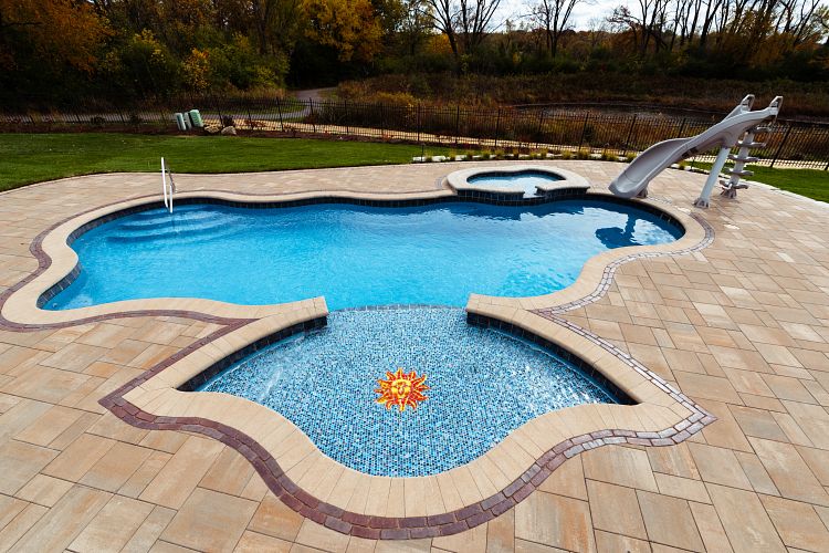

My PB just installed a Latham/Viking FB pool at their home as their "showroom" pool. They also have the Ocean Blue, but the G3. As it is their "show room", they have just about every option available installed, including the tiles.
According to my PB, the tiles are an option when you place the order for the shell, and come delivered from the factory. They have both the waterline tiles and the step tiles. I didn't take a pic when I was there, but did ask for them to send me one.
I found it very difficult to find the options available from Latham, downloaded their brochures, looked around, but never was able to see the actual option list. From what I gathered, there are different tile options, mosaics, and even custom ones you can have put one, but think the best way to see all the options is talk with the PB who will be ordering your pool.
The Latham site shows a picture of the "Magesty" model (The model we are having installed) with the waterline and step tiles, maybe this will help a bit....
