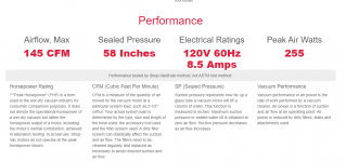

Shop Vacs really are not made for pressure.
They are designed for airflow and some suction.
You can look up the performance of a shop vac in the specifications data page.
For example, this one can do 58", which is 4.8 feet.
If the main drain is 8 feet, and the shop vac can only do 4.8 feet, then it won't work.

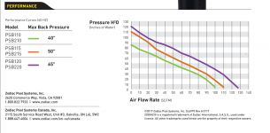

Below is a chart for spa air blowers, which work in a similar way to a shop vac.
The air flow rate decreases as the back pressure increases.
