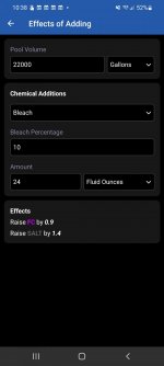

I think I'm having an issue with the app. I'm sure I'm doing something wrong. When I use the "Effects of Adding" section it does show that 3 cups of 10% chlorine will only raise the FC by 0.9. However, when I'm looking at the Home Screen and click on FC the recommendation is to add 3 cups to reach the Target Free Chlorine of 3.

HAHAHAHAHA!!! I'm an idiot.
@PieterS and @bertschb for the WIN!!!
