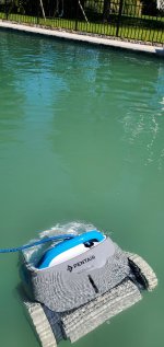

Progress. Robot is now visible at the bottom of the deep end. This morning I couldn't see more than 2-3' down. I bumped my SWCG up to 100% (usually run around 40-45%) thinking that would help maintain SLAM, and my FC shot up 5 pts. Only .5 CC at last check. 20210902_151823.jpg

I doubt you need to get aggressive with chlorine. Just keep 20% of CYA for the FC level. This is a filtering exercise. Your DE filter should do quite well. Watch its pressure readings.

Thanks, Marty. Not knowing what I was dealing with I bumped FC up to SLAM, but now that I've seen little loss or presence of CC today I'll let it fall back to 20% of CYA. Appreciate the support.
