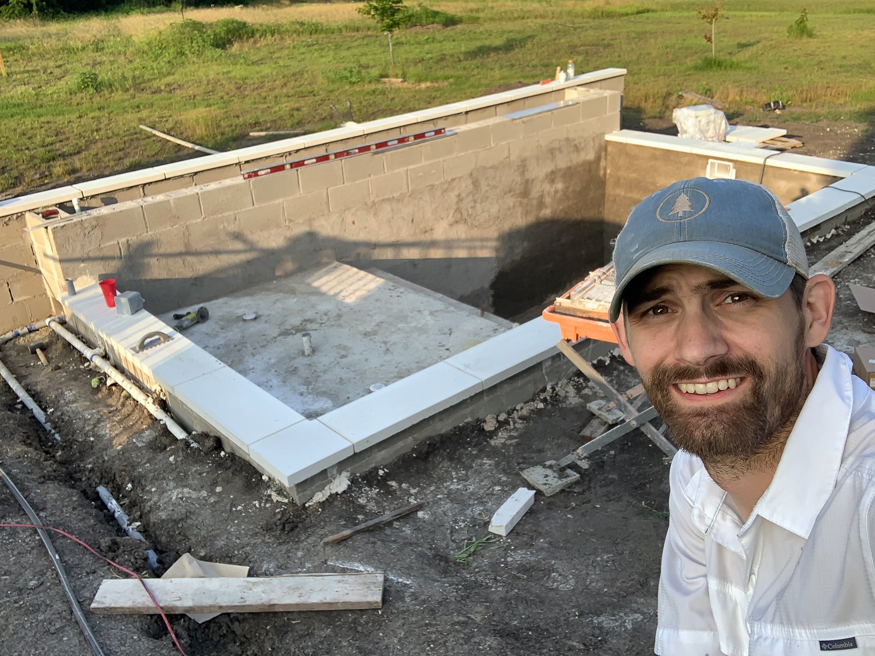

Ive been reading and learning here for over a year and I'm excited to start this build thread now that we are getting close to making this thing happen! Nothing here is set in stone yet, its just where my plans are at. I would love to be ready to dig mid next month but I also have no time table here, we just want to do something fun, that will last and be a great build project.
I am embarking on a very small "Dip Pool" or "Plunge Pool" and am planning for this to be about 70% DIY with some additional contract labor to help and currently in the planning and research stage. I plan to post more detailed build plans, drawings and eventually photos along the way here but I have a few questions to start if anyone has some help they can offer. Right now im in the final research phase of materials and creating my buying lists. I have a few questions (at the bottom of this post) currently, but will update that as we get through this process.
Basic Design Ideas:
  • This is a BUDGET - DIY build here. So I want to do things as well as I can, but cost is a factor on nearly every step.
  • 9x9 square 4.5' deep plunge pool with a 6x9 sun deck attached.
  • Overall dimensions will be 15'x8'
  • Sun deck will be 10" deep (unless anyone has a better depth to suggest!)
  • Pool will be a concrete block construction with plaster finish, glass beads added if I can source some that I like.
    • Planning on pouring a 6" thick steel reinforced slab on the bottom and building walls and steps with concrete bloc, reinforced with rebar.
  • Bond Kote (sp?) application before plaster.
  • White plaster with white, clear and/or iridescent glass bead.
  • Equipment:
    • Looking at above-ground pool pump because I will have a pump house below grade and its only about 3,500 gallons so these pumps seem to be ideal for this purpose.
    • 16" sand filter
    • Salt chlorinator generator
    • Looking to add a large heat pump OR cold/heat pump - electric because I can't get gas to the location.
      • The purpose here would be to have the ability to heat near 100º f in the winter so its would be a large hot-tub.
      • I also like the Raypak Cold/Heat pump that can also cool the water in the Texas summers- its pretty expensive but I might want to add this ability.
    • Controller: No idea here. I would LOVE some basic "smart" controller if there is something that can run the pump/heater/SWG and/or lights or something. I MIGHT add a waterfall feature but not there yet.
Immediate Questions, ill update here whenever I get to a new stage of questions:
  1. Glass bead suppliers? Where can I buy glass beads. I seem to just hit a wall on anything other than the big-name brands
  2. Suggestions on cold pumps? Im wondering if anyone has used these?
  3. "Smart" controllers that are $1000 or less? I would love a control board that could connect to my phone or something. Having a "remote" seems pointless these days since most of my home is automated and its moving that direction. Basic control/programming from my phone would be wonderful. Ive looked at the Hayward OmniHub which I can get locally for about $1k. Wondering if anything cheaper is out there.
