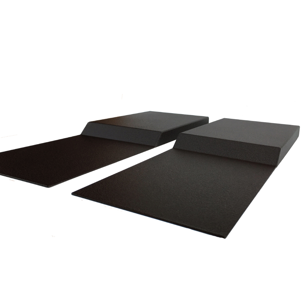

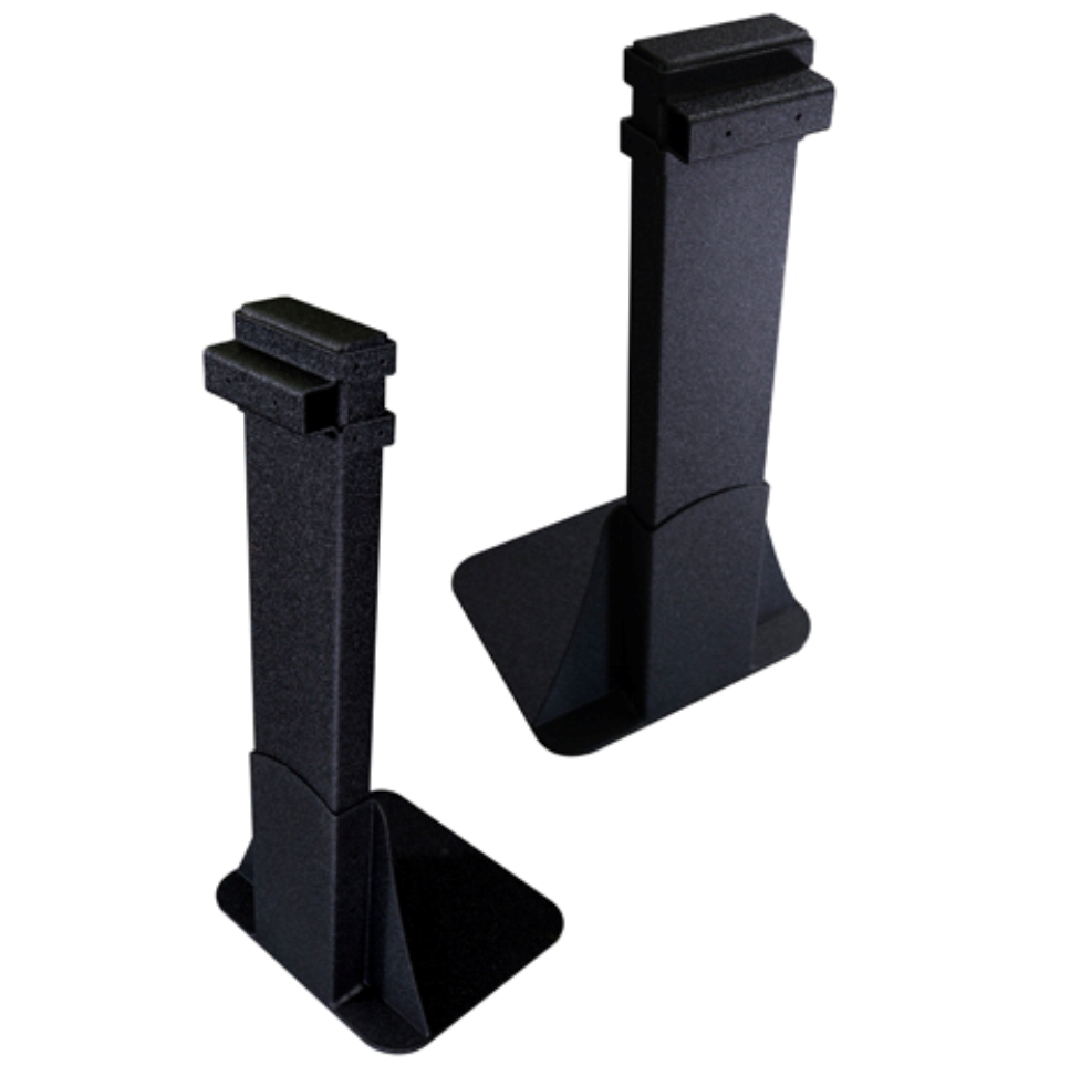

I'm considering this cover lifter: Cover Caddy - Cover Valet
It doesn't require drilling into cabinet and lowers cover so it's not blocking view.
That one just seemed a little flimsy looking when I was doing my research...
You can get the no drill option on the Boomerang also, but again pricey!!

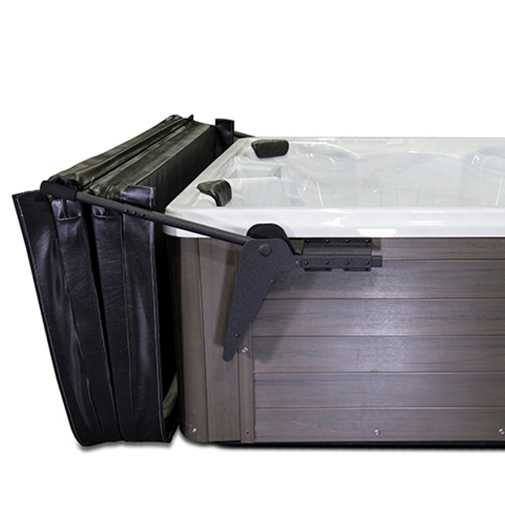

I've installed many, many, many cover lifts, but never one of those. Not even sure it counts as a "lift". More like a cradle, like hot springs used to use.
This is the style I recommend. There are several varieties by different manufacturers, but basically the same thing.
