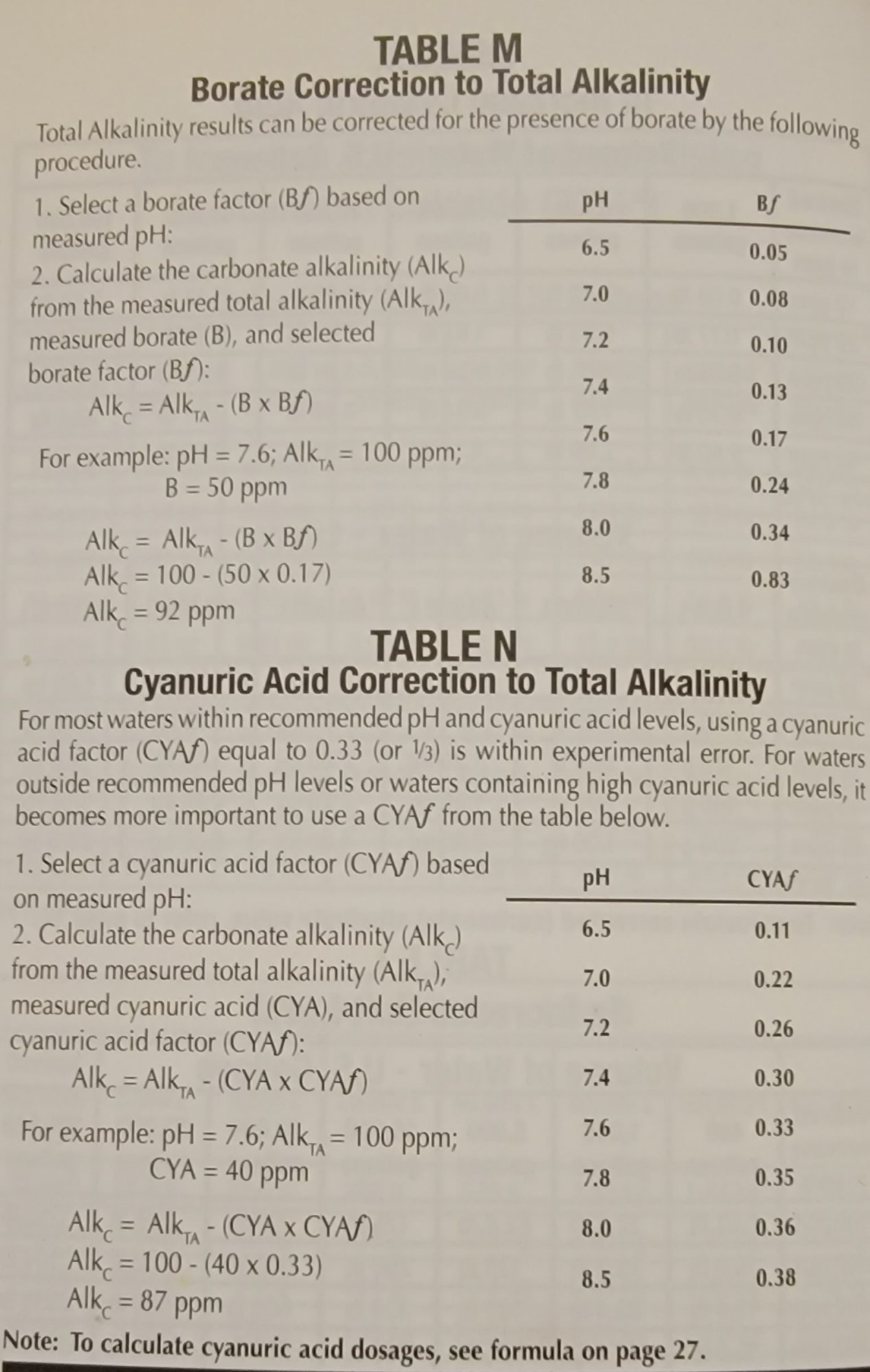

Borates add alkalinity, but not 20 ppm for 50 ppm borates.
Testing variations is most of it.
It s discussed on the pH/TA video on TFP TV.
