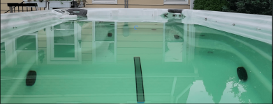

Hi all, I am the happy new owner of a Tidal Fit EP-15 Swim Spa. Overall we love it and things have been going well with it. However, its been leaking slowly and the concrete pad is constantly wet. I spoke with the dealer and they are saying the reason its leaking is due to me over filling it. It didnt seem over filled to me but they said if I filled over the filter door (the one that floats up and down) then that means I over filled it. They said that the hooks and attachment points for the exercise equipment are not water proofed and that is where its likely leaking from.
I believe they are correct in why its leaking, I let the water leak out for a couple of weeks until it stopped leaking when the water level got lower. Then we had a big rain storm and the water raised up and it started leaking again, so I think that pretty much confirms the cause.
However, is it normal for the spa to leak if slightly over filled? I was talking to someone on reddit who said their swim spa was overfilled by 4 inches with no leaking. I am very tall so I prefer to have the water level a little higher so am disappointed I cant fill it as high as i would like. The water is far below the top when its filled to the level that doesnt leak. I want to also make sure the dealer isnt just getting out of having to fix the leak if its not supposed to actually leak in this situation.

Water level when leaking. You can see the silver colored hooks that are where the dealer says its likely leaking from.
On my hot tub, many manufacturers recommended fill height is to the bottom of the lowest pillow. One bather will raise the water level enough so the neck jets are submerged. I believe Tidal Fit is a May Manufacturing product (Artesian) and that's what they say to use for fill height in my owners manual.

I got to thinking about this and regardless of fill height, the inside of the shell shouldn't leak. I would be calling the dealer and having them come out and seal the thru fittings. Same with taking care of the cover.
If you have enough bathers at the recommended fill height, the water level is going to submerge the fittings. They should be water tight.
Reactions: Mdragger88
Normal. Very few spas are designed to be waterproof above normal fill height. Some end up that way due to the specific fittings used and such, but none are made to be so. Some actually have a buil-in overflow drain so you CAN'T overfill.
Also, the exposure to water in your air controls is going to trash the built-in check valve and make it leak even faster when overfilled. Filled above the skimmer door and your skimming ability is all but gone. Pillows will also suffer from submersion if your chemistry isn't perfect. Jet action from filter cycles may contact the cover, which can speed it's demise (again, depending on chemistry). And an extra 4" in a 6'x10' swimspa is an extra 1200lbs or so too.
