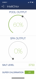

Ok I think I got it! I wasn’t absorbing the dual action only the disassociation. I followed step 1 and step 2 (see screen shots). So if I’m now tracking these directions when I set my SWG to 60% toggle and superchlorinator on and then return to ScreenLogic config to recheck box for intellichem present the chlorinate is now on until I shut it off?

So I’m seeing now any numbered % value means it’s on and super-chlorinator would be if you’d want to up the cell so high as to ‘SLAM’ ( I use that term lightly) but why would you unless u want to shorten the cell life. Thank u Hansatb for being the smart one! I am free of the ORP probe..thank goodness!
The IntelliChlor has a cycle time of 5 minutes. That means if it is set to 60% it produces chlorine for 159 seconds of each 5 minute period.
When you set it to Super Chlorinate it generates at 100% for 24 hours then resets to the generation %. That is not enough chlorine for a SLAM FC level. And you hardly shorten the cell life by more then one day.
Running the IC60 at 60% for 24 hours would produce 8 ppm of FC.
Running the IC60 at 100% for 24 hours would produce 13 ppm of FC.
