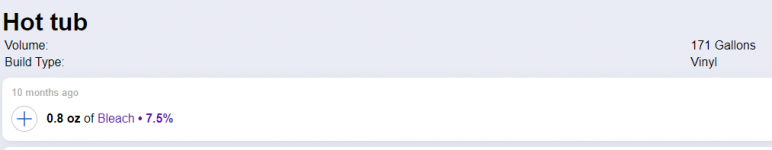

I selected on the app to link my TroubleFreePool.com user profile. But I'm guessing it's not working (probably user error?) Also, how do I get all of my pool stats to show up on under my avatar?
If I click on your avatar, I see the button for "Pool Math Logs"
The last test I can see is from 10 months ago, but it is for a "Hot Tub" which you must be sharing with TFP.
Do you have multiple pools in the app? I actually have three in my Pool Math app. My pool, then I keep one for one of my neighbors, and then one for a different one as I'm always helping them with the TFP method and they have different sizes and equipment. But when you click my avatar and see my Pool Math logs, only mine shows up, not the other two, which is what I was going for. I go to my pool, then click the gear icon and scroll to the bottom for sharing. I have my pool set to share and not the other two. Seems like you have the hot tub set to share, but not the pool.

Thank you! I have deleted the other two and left my new pool, so hopefully you are able to view it now.
