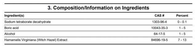

Agree, its clearly not the boric acid. The levels we are using in the pool is way way less than what people put in their eyes routinely, and adding 10 lbs to a 30 K pool is a an irrelevant amount of addition of borate.
