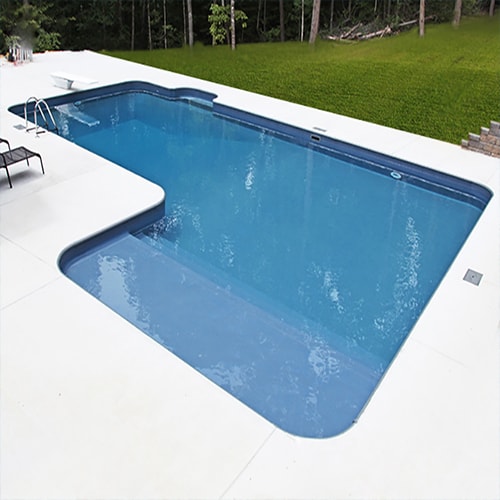

For the boy child is there any way you can do a L shaped pool? The foot of the L could be the soccer field.

The L shape... something to consider, I suppose it would be a shallow area like a tanning shelf/ whatever it's called? He plays soccer wherever he can, so he would definitely take advantage of that!
Here is a purrfect example of what I am thinking for your pool. Note how the foot part is all one depth. I would have it 4' deep for max fun.

Thanks for the inspiration! I'm thinking of something similar, but a spa that's right next to the shallow end (in place of those steps you showed, would be a spa). I have some inspiration photos and photos of my mess of a backyard... I'll post once I figure out how to resize them so they aren't too large.
