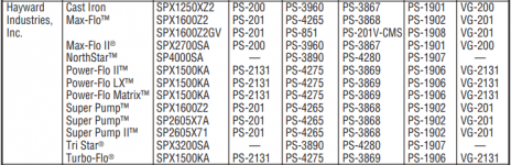

As you can see from the reference posted earlier, there are different quality levels of seals.
The PS-3868 is the minimum acceptable seal, in my opinion.
You should install the seal with seal installation lube and nothing else.
You should check the pump for leaks on a regular basis to catch any leak as soon as possible.
I recommend checking once a week for seal leaks by looking under the pump with a flashlight.
