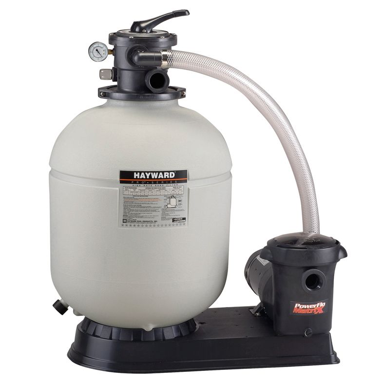

If you get one of the Intex sand filter pump combos it should be easy to plumb to your pool. If you want something higher quality any 2 speed or 1hp above ground pump will do. Pentair, Jandy, Hayward, and Waterway are the most common brands. Look for an 18-22" sand filter that holds around 150lbs of sand.

Pentair (sand dollar) looks like the cheapest... Hayward gets the most search results... Jandy and Waterway appear to be from the same company
