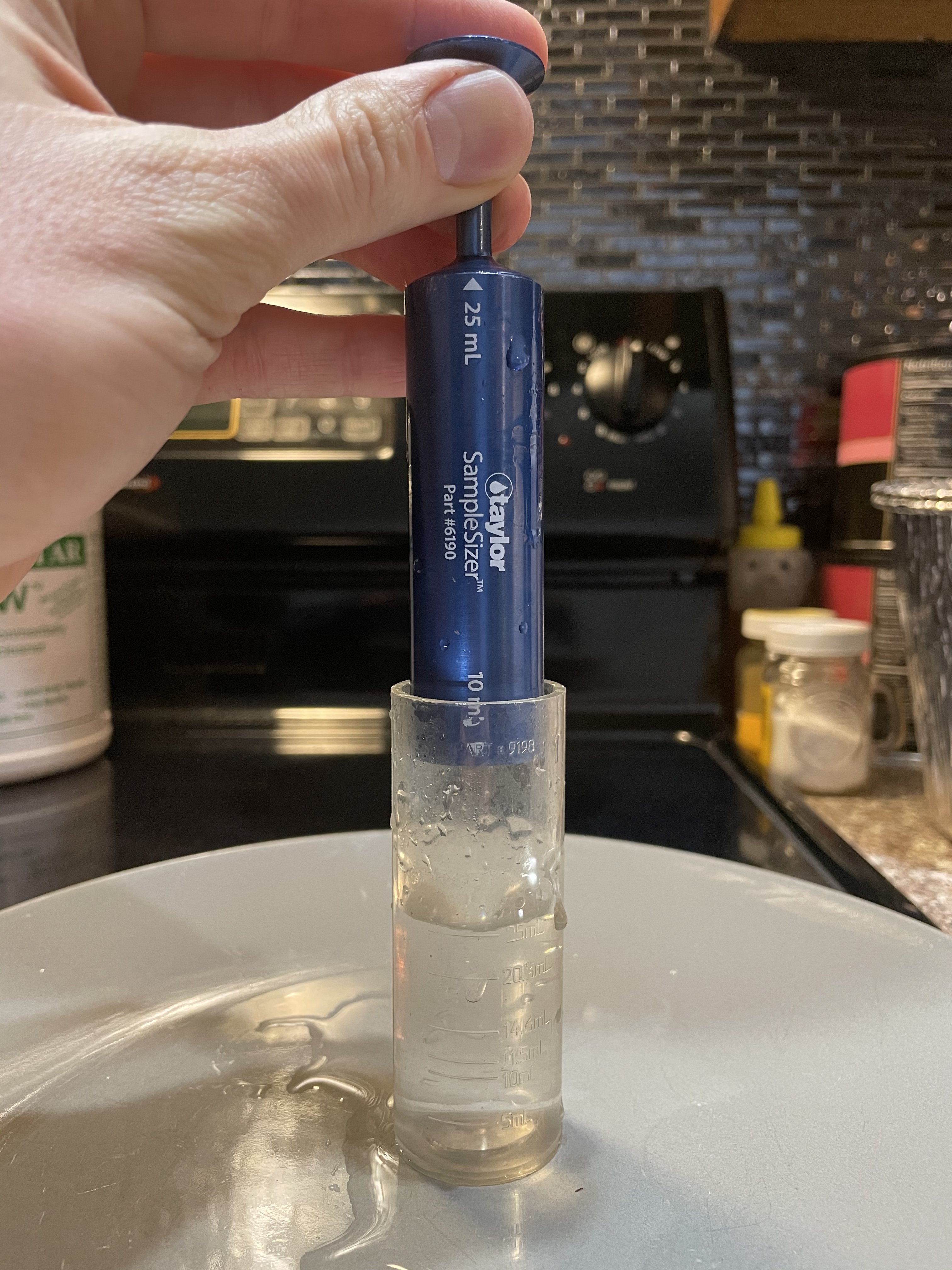

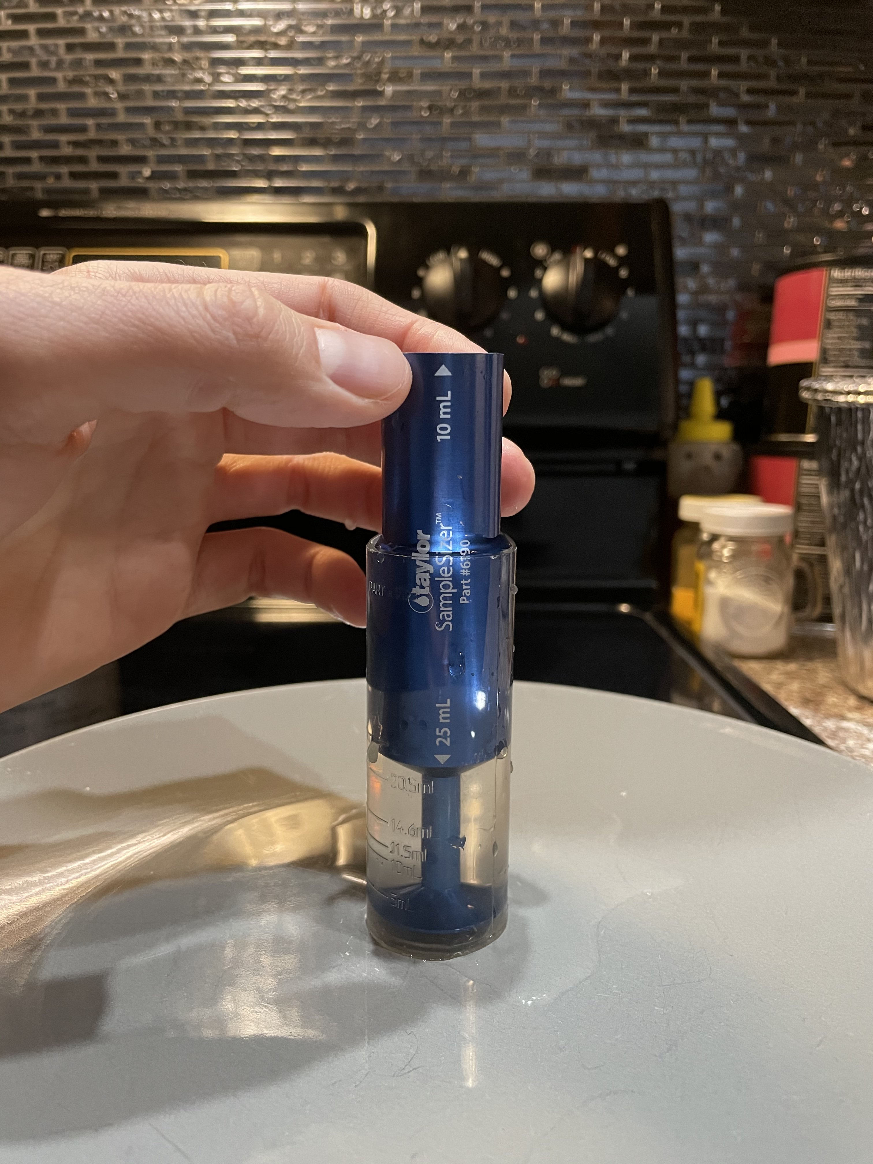

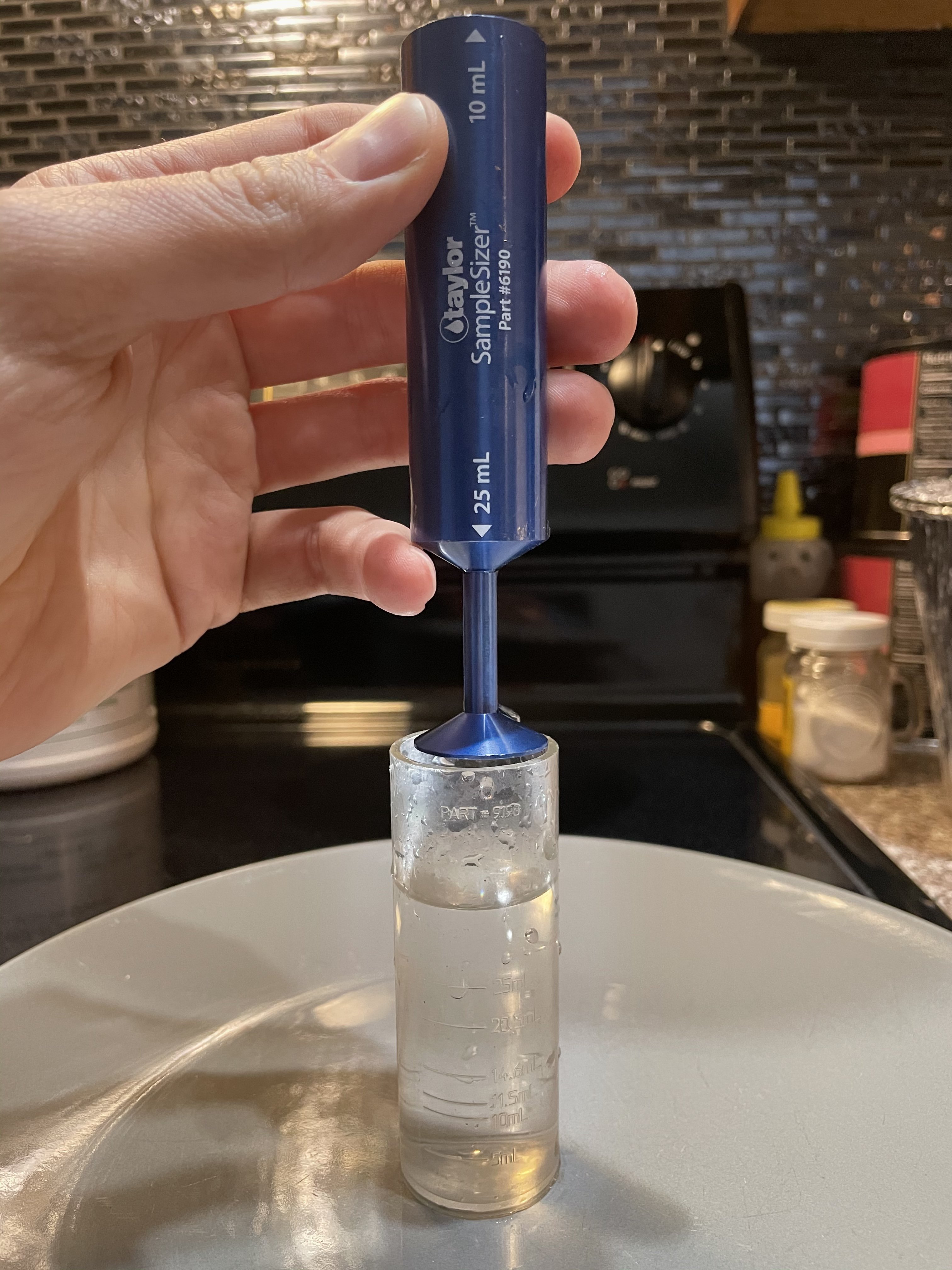

Previous I’d been using a 10 mL syringe to measure out my samples, since 10 mL is what I use for FC and also for TA when filling a spa, and it also worked for 25 mL by filling twice full and once to 5 mL. I thought that was great...
But on my latest refill from TFTestkits I threw in a SampleSizer. I’d heard people say how much they liked it. Well THIS THING ROCKS! It’s one of the times I’ve gotten a specialized tool, then kicked myself for not getting it earlier cause while it only does one task, it does that task extremely easily and quickly.
This thing could not be easier. Rinse and fill test tube, fully lower in SampleSizer, remove, and you have a perfectly measured 10 or 25 mL sample depending which end of the SampleSizer was facing down.
Here’s a series of pictures showing how easy this is. Fill, lower, raise, done.
Just like the SpeedStir, you can live without it, but really you really should get it, it’s totally worth the money.
One note I found here on TFP: This does not work with the test tubes in the TF-100 test kit, it needs a Taylor 9198 test tube. This tube comes with the SpeedStir or the K-1766 salt test kit, or can be bought separately from TFTestkits.net or elsewhere.

You have to overflow the vial and spill water?
jseyfert3
Oct 20, 2017
1,447
Southern WI
15000
Yes. It works via displacement. You always fill the vial to more than you want for your test. This is any amount more from one extra mL up to a full vial. You insert the SampleSizer and it pushes all but 10 or 25 mL of water out of the vial, so when you remove it just the right amount of water is left to do your testing.
