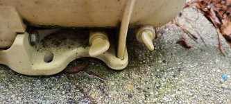

Picture with notations attached

Update. After swapping between filter and recirculate mode and running in recirculate mode the pump was again filling with air. Should I be worried about a bad pump?
Attached are some better pictures.

Any leaks in a pump on the suction side can get air into the system.. why exactly it does not happen when in recirculate I have no idea...
The leak on the pressure side will not introduce air into the pump basket..
If these 2 are leaking it will allow air into the pump.. Did you lube the O rings?

Thanks yes they were lubed but I will double check again to make sure there is no grit or anything that got in there. Yeah losing pressure in recirculate mode surprised me.
