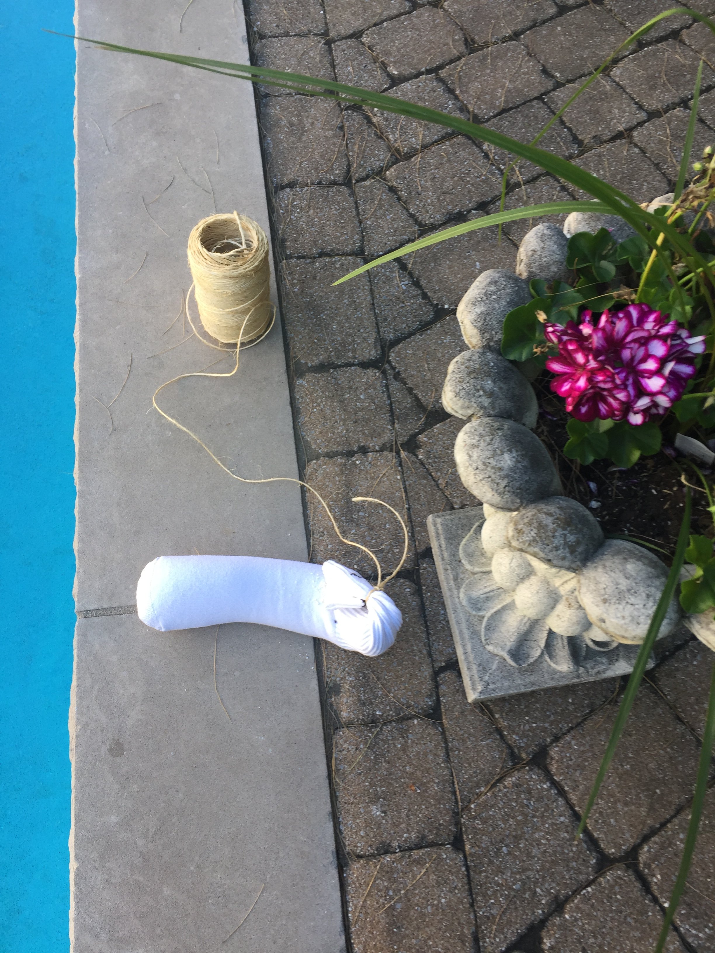

Trying to figure how I want to do the CYA. Used liquid stabilizer when pool was swamp; have 2 gal which would only get me half way to 70 ppm. What is shelf life of the liquid? Thinking I might want to use dry stuff now (or 1 gal liquid + dry stuff) and tweak CYA with liquid later.
Any preference between Clorox or (HD) Pool Time dry stabilizers?
See sock method is usually focused around skimmer, but most chems are added near returns. My returns have stronger circulation than the skimmer...
CYA posts vary on how long to wait for testing after dry is dissolved - some say 24 hr, others a week. What's the current standard? IIRC, was 2 hour wait for testing with liquid.

The sock method works as just as well in front of the returns as it does the skimmer. I just hang mine in front of a return when I need to add some. Usually you should wait 24 hours. Squeeze the sock occasionally if you want to speed up the process. I don't have a brand preference. Using the liquid to tweak your CYA sounds like a plan.

The only difference is liquid CYA is more expensive.. at least when I have priced it. I would use up the liquid and switch to Dry. I buy my dry CYA in bulk and it will usually last 2+ seasons. Its one of the few pool chems that stores well.
Most people have more vigorous flow through the skimmer so they throw the sock in there....I have no patience for letting the sock sit there and waggle in front of the return, I squeeze until it all mushes out. That takes about 20 minutes.

Yes, the liquid is more expensive. I opted for that pre-SLAM to avoid my snakes. :LOL: Wait period for retest is why I'm thinking of using the liquid last. Wouldn't think I'd be adding much stabilizer at a time after getting to my target level, so would be easier with liquid ... and don't have to put my hand in cold water to help the dry dissolve. :giggle: All of this is based on my assumption that liquid stabilizer has a decent shelf life.
I have a floating weir and maybe that makes a little difference. I could, of course, change the balance to favor the skimmer rather than the 50/50 split I have with the main now, but I think this gives me a better mix while I'm fussing the chems.
yeah.. do that.. it will only be for the time it takes to get the CYA to dissolve. Then you can go back to 50/50

Just be careful with socks in the skimmers. Many pool owners get them sucked thru the system and clog or make it to the pump basket. I always hang in pantyhose leg on broomhandle in front of a return. If it's a rush I use liquid
