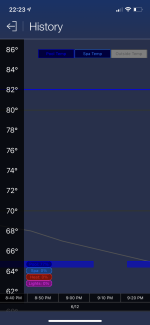

Not sure what to make of this so not going too get excited yet: Checked the app this evening: Pump was off. BUT no power outage alert or communication lost alert. It appears it went off around 7:10pm. Schedule is running 7am to 7am.
I select pool from the pump menu and it came back on. I then saw an alert: communication lost but it went away. I’ll continue to monitor and see if anything else develops.

You are causing half of your problems yourself.. When you push the "Pool" icon to turn the pump back on, it starts the egg-timer and can screw up the schedule.. Depending on when you do it, it might take the system 24 hours to catch up.
Try running 8 am until 8 am... And see what happens.. It should not shut off..
Show me your egg-timer list.
One step at a time.. we will eventually get there.. :mrgreen:

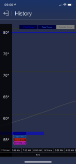

So it happened again this am. Around 8:10am the pump shut off. No alerts though. Had been running the schedule since last night 8am-8am.
So I’ll turn on at the panel and see?

It makes no sense at all that the pump shuts off after 12 hours, if the schedule is set for 24 hours... :scratch:
The only thing I can think of is that the pump is shutting off due to the egg-timer and not the schedule..
Two things you could try.. Make sure the pump is off say at midnight and see if the pump starts on its own at 8 am the next day.. and then see if it still shuts off after 12 hours. (I'd try this first)
You could also set the Pool egg-timer to "Don't turn off"...
Jim R.
