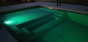

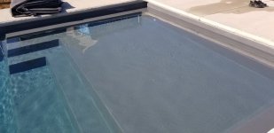

Casey
Apr 16, 2007
12,297
SW PA
17000
Fiberglass
Jandy Aquapure 1400
You can see my return on the ledge n how my steps are. I have to keep it covered with water. We drained right below the skimmer n I still had water on my ledge with just capping the return lines and using a jug of antifreeze in every return line, the slide line and skimmer line.

Winger 03
Sep 7, 2009
356
Frederick County, MD
Thanks for replying. Do you have a tanning ledge? I do. I was told not to drain the ledge so going a ft below my returns would expose the whole ledge and I can't do that. My ledge measures 16'widex8'long and the steps are centered to walk into the pool.
I do not and that makes your situation different from mine. Ugh, I wish I had an answer for you. Knowing you have a tanning ledge, I think you are fine as is.
