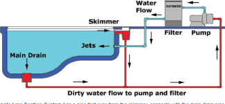

There is only one opening in the skimmer... So I guess the setup is something like this:
How would I go about getting the air out of the lines in this case, if the main drain is connected to the same plumbing? Would just loading up the pipes with extra antifreeze be sufficient?

You could use antifreeze. Is there a shutoff in front of the pump? You could blow air from the pump into the line, plug the bottom of the skimmer while air is bubbling out, then turn the shutoff to airlock the floor drain.

That makes sense - I can blow from the pump back into the lines - and just keep one skimmer/drain valve open (of the 3 in the picture) and follow your procedure for each. I'll give that a try and see how it goes.
