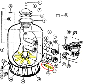

The laterals are near the bottom under the sand and you will carefully need to remove the sand and inspect them.
Just about any Manu. Web site will show an exploded diagram of a sand filter and it will rapidly make sense to you. If you do this, you certainly can save the sand for reuse. It is not a quick job but it sure sounds like that may be the issue

Here's an image I stol.... er.... borrowed from Hayward's website. It's an exploded diagram of a Hayward S310S above-ground sand filter. I took the liberty of highlighting the laterals.

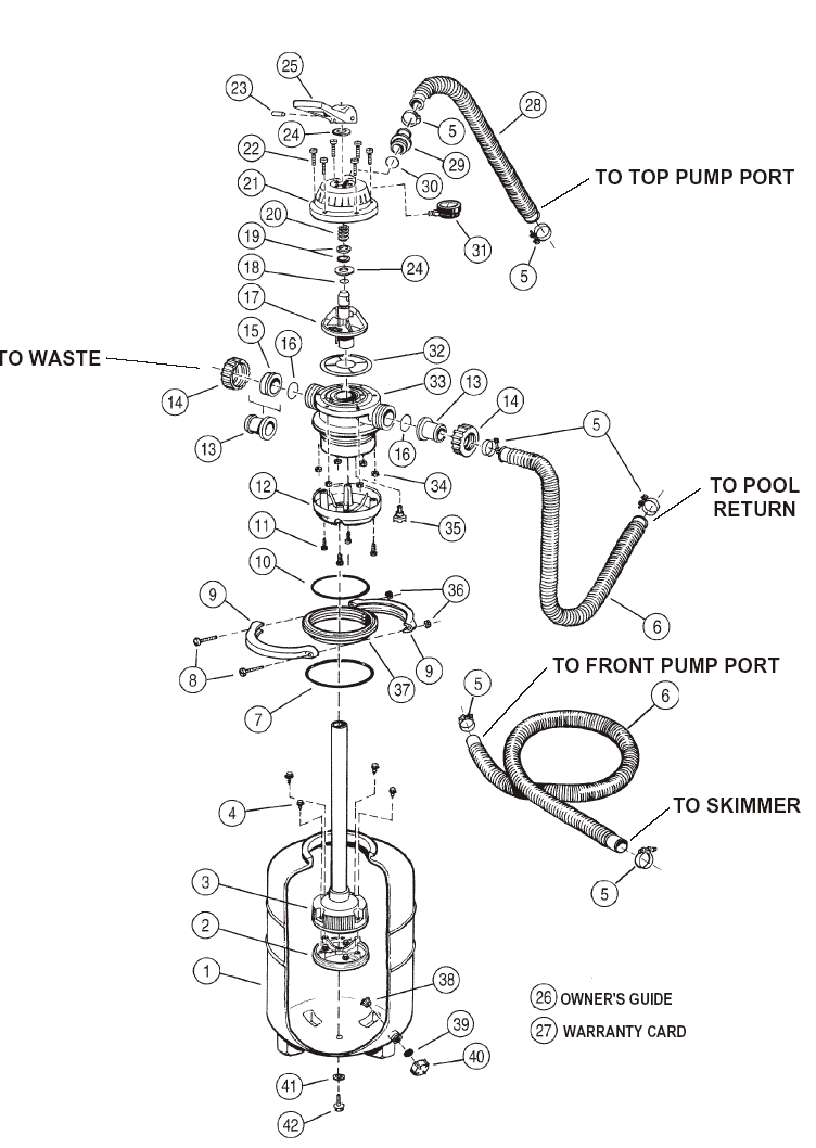

Here is the schematic for the filter I use .. it's dark outside so I'm not going to mess with it until the morning. They refer to the portion in the bottom as the "underdrain", which I would imagine houses what you are referring to, although the diagram is not clear.
Oh .. as far as backwashing goes .. that is one of my concerns. I'm getting around 15 PSI under normal filter operation. This does not seem to be changing at all unless the SKIMMER sock gets significantly clogged. The filter itself does not appear to be building up pressure. I backwash for a couple minutes and nothing really changes. I don't see much dirt coming out the waste side either. For as dirty as my pool has been, there should be all sorts of crud.

Well .. I've more or less decided that the filter is fully operational. I can find nothing physically wrong with it that would cause the sort of problem I'm having. Apparently Doughboy Media Master filters don't use traditional laterals, but rather some sort of one piece underdrain.
The only other possibility I can think of is the pipe that leads from the multi-valve to the underdrain is not mating properly and is allowing water to flow directly back into the return. It's not broken or damaged as far as I can tell however, so I'm not sure why that would be.
