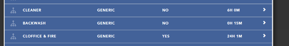

I cant figure out why Fountain is not in both lists if this is the case. (please see attached and please comment if I have this right, in my system the only thing that changes pump speed is booster pump which is a separate pump, cleaner, and backwash)
With all of this being said, if you put things in the wrong place, there really is no detrimental effect.

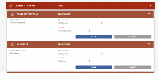

Let me see if I can explain a little bit better. Bear with me. This may be a lot to digest.
AUX circuits are circuits that are tied to a physical relay inside the panel. So anything that you might need to switch power on/off to in order to control it, would need to be an AUX circuit. This is pumps, lights, spa blowers, etc.
You can see in mine below, I have the Spa and Pool, which controls the Filter pump, Feature Pump (aux 1), Air Blower (aux 2), Pool lights (aux 3), Spa light (aux 4). Then I have 3 remaining empty relays, for future use.
Feature Circuits are circuits that allow you to control internal functions of the software or panel. This consists of valves A and B (and C through H if you have the expansion module), or also allows you to control pump speeds independent of the Aux circuits.
In mine below, the Wall Waterfalls, Deck Jets, Cleaner, and Bubblers all actuate a valve and set a pump speed.
My cleaner circuit actuates a valve and increases my filter pump speed.
The spa waterfall is my spillway circuit and that actuates the return valve actuator to send all water to the spa.
Skim high and Sprayer are only there to set a pump speed, for when I want to skim the pool surface, or during the summer when I operate a sprayer to help cool the water.
All of that above to say, if it requires turning on and off a power source to control a device, it needs to be an AUX circuit and go through a relay. If it only requires actuating a valve actuator (A-H), and/or setting pump speeds, then you would use a feature circuit.

Here is how I have it laid out now
Cleaner - pool cleaner that changes speed of the pump when activated
Backwash - changes the pump speed to a higher rpm when activated
Booster Pump - Turns on a seperate pump from the pool pump - mostly to increase water into the spa when we use that
Fountain - turns water flow into the fountain - no change of speed
Now, I can not figure out how to delete these duplicate items from the AUX Circuits.. In your example, you select "select circuits". It wont let me select anything and if it did what do I select so that it doesnt show up on the Aux Circuit menu?
In addition, I tried to set the Backwash and Cleaner to "None" in Aux Circuits and added them to Feature Circuits. When trying to activate them in the features menu, nothing would happen (valves didnt turn, speeds didnt increase) This would be regardless if I set those to cleaner and backwash or to none. When I deleted them from Feature Circuits and they were only in Aux Circuits they worked again.
I am super confused.

Here are my screenshots as I changed everything back to how it was before I changed things to feature circuits as those devices stopped working when I did it. So I changed it back to the working state
Lets take Backwash as an example. I renamed the circuit to "none" and associated it with "none" in the selection., I then added it to Feature Circuit and selected Backwash. It would not work. Then I changed the Aux Circuit back to how it was so now I had backwash in 2 circuits (Aux and feature) . It would not go on. I then deleted in the feature circuit and then it worked. Same for cleaner
to answer your questions:
I upgraded from an Easy Touch 8 to the Intellicenter and did it all myself. No one has done any programming. Booster pump is lPump 2 and I turn it of via aux circuit and it shows up in features as it the box is checked for show in features
Perhaps the mistake I made was selecting 'None" instead of generic for the Aux circuit when I changed it? I am begining to think that this is not so much about moving things to different circuits or duplicating circuits. They will always be "duplicated". In Aux circuits, you are simply renaming things (not moving or changing them" to avoid confusion?
Here is the screenshot where I attempted to change Backwash per your instructions and now it doesnt turn on. It used to be in Aux 6
I noticed Fountain is set up correctly. There is no empty aux circuit representing that and it only shows up in feature circuits. I just cant figure out how to get it that way for Backwash and cleaner. Fountain works correctly.

Changed the Name of Backwash in Aux Circuits from Backwash to Aux6, unchecked show in features. Now in pumps it Says Aux6 when it used to say Backwash
Added Feature Circuit called Backwash, with show in features selected.
Went Back to Pumps and there is no selection for Backwash. Only Aux 6

Weird... It worked for me when I went through all the same steps I listed out for you. The new Feature circuit "Backwash" showed up at the bottom of the circuit list.
I just tried it again and it took several minutes for the new 'Backwash' Feature circuit to show up. It will be at the bottom of the list.
Give it a minute for it to populate in the pumps circuit selection.

Hoooray. It worked... I had to refresh the webpage on the pump page. I cant thank you enough. I am going to try the other circuits now.
