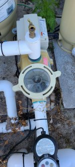

I tried to catch an image of the bubbles but failed right now. They are now small since I increased the pump speed but the check valve still has what appears to be an air pocket inside of it but I'm not sure how it can get there unless there is a leak and the air side of the spa jets is letting air in somewhere but considering that only happens right at the jets I'm not sure that possible. When I stop the pump the check valve water drains which is also a little confusing. Here are a couple pictures of the pump (couple air pockets but I think it's normal) and the check valve.
I might try to upload a video later to show everything better.
You're talking about air bubbles you can see through those plastic covers? Sometimes I've had bubbles there and sometimes I haven't- since day 1 of my system operating. I've never really watched them; their presence has never negatively impacted my pool.
Did you turn off your SWG for a period of time to see if the small bubbles coming out of the return line disappeared?
