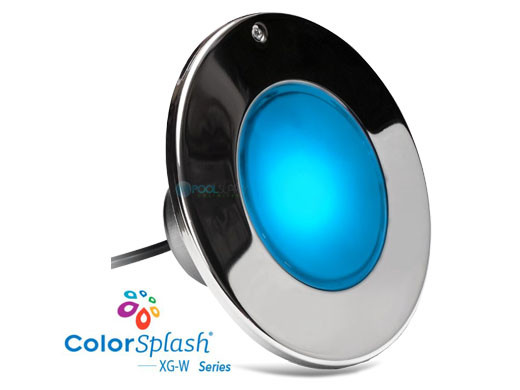

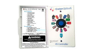

I recently installed the J&J Colorspash XG-W and the Bluetooth controller. I'm very please with how bright and colorful the light is. I haven't used the Bluetooth function's yet but the controller works great.
