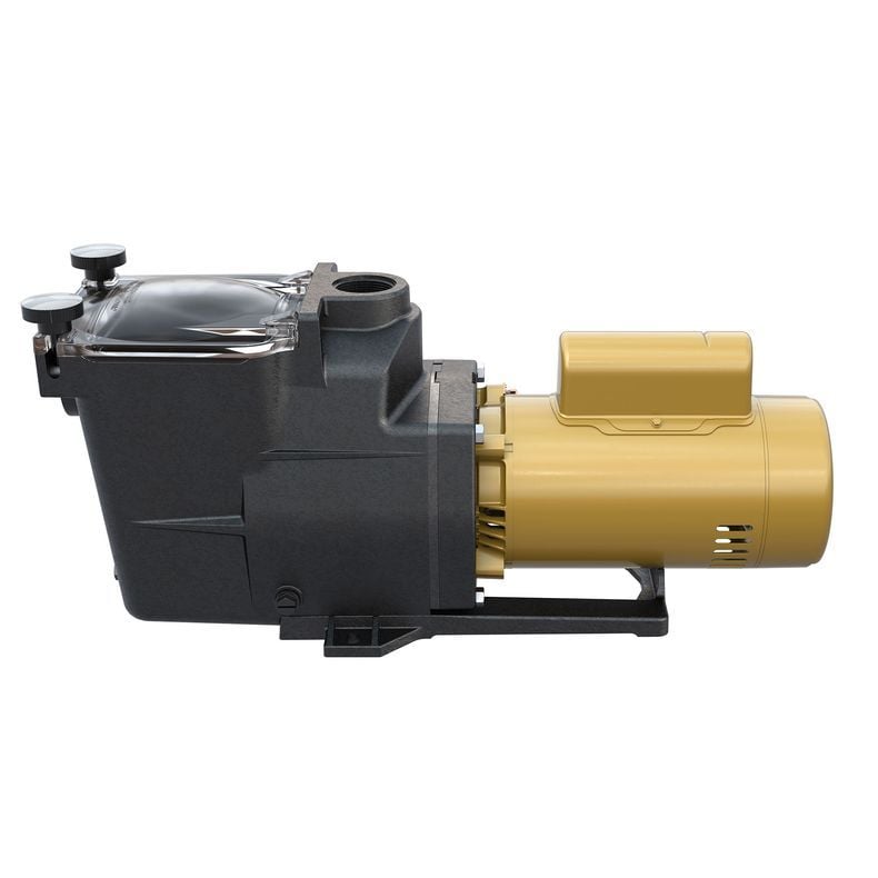

I have an in-ground, salt swimming pool. The entire setup is outdoor in a city that snows a lot (motor, salt panel, heater, filter). My motor (Hayward Super Pump) has lasted 7 years up until a few weeks ago. The pool company replaced the capacitor which lasted 3 weeks. When I brought the motor back for repair, the technician told me that the motor was completely burnt. They told me that usually pumps last 10-15 years, and the reason mine didn't was because it was running on 120 Volts.

An induction motor running on 120v vs 240v has exactly the same current and power running through the windings. There are two separate windings (one per pole) in a dual voltage single speed motor. The two windings are fed in parallel for 120v and in series for 240v so the voltage drop across each of the poles is 120v and the current is exactly the same so the power used and the power dissipated is also exactly the same. The only part of the motor that carries higher current is the terminal block and maybe the thermal limiter but they are dimensioned for the higher current.
Motor quality has dropped off significantly over time (in my opinion). It might have been possible to get 10 to 15 years previously under good conditions. However, you are lucky to get 5 to 7 years with the current motors.
One of the main causes of motor failure is a seal leak that gets the bearings wet and causes corrosion. Check frequently for a seal leak and fix immediately if a leak occurs.
As far as 120 vs. 240, I would always recommend 240 volts if you’re running new power. If the power is already installed at 120, it’s probably not worth running new wire to change to 240.
If the power supply wires are undersized for the pump, you can get excessive voltage drop, which can cause problems. You can check the voltage going to the pump under load if you have any reason to question the power supply.
Make sure to keep the motor clear of debris so that the fan can circulate air over the motor and keep it cool. There is a fan attached to the shaft in the motor that pulls in air from the front bottom vents and pushes it out of the back bottom vents.
