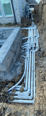

The plumbers/electricians came by this week to run the pipes and install most of the equipment. Still waiting on the 3hp VSP. There have been some delays in receiving parts. I also bit the bullet and picked up a glacier pool chiller. I didn't realize how much of a unit this thing is. It's an absolute beast.
I was chatting with the plumbers, and they mentioned this pool was the first one they put a bypass (with returns) in for the IFCS. They did say it was a good idea.
I had the equipment pad installed on the opposite side of the house, where the gas meter and electrical panel are located. With this and all the plumbing with the IFCS and my additional floor/calf jets, it took them a good two and half days to complete the job. They usually complete an install in one day.
You will be glad you did it. Even if you only need to use it once, the ability to be able to isolate items and keep the circulating/filtration system operational, is worth it.
