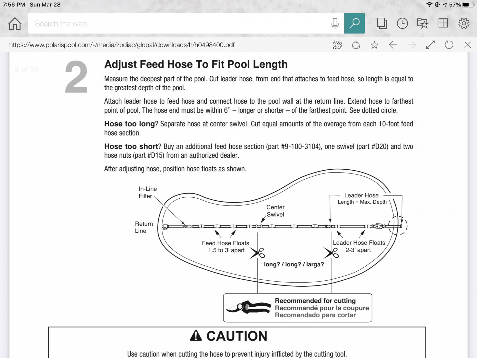

Are both of the red circles swivels?
You should only have one swivel at the halfway point of the hose.
You are missing a float 2-3 feet after the float by the backup valve.
You have too many floats on the back end of the hose. You need two or three floats before the swivel to keep the hose steady as the backup valve jets.

Recommended hose setup below. Note where floats are between backup valve and swivel.
Disagree. There is a center swivel and a second swivel joining the feeder hose and the leader hose as shown in the diagram. 3 sections of hose require 2 swivels. IMHO you can't have too many swivels, and getting rid of a swivel is not only pointless, but literally impossible without replacing a whole stretch of hose. I do agree that the floats need better arrangement.
I would agree with @Rocket J Squirrel
There are a couple of critical lengths to minimize hose tangling. Those 2 feed hoses should be equal lengths with a swivel between them. Then a swivel that connects the feed hose to the lead hose. The overall lead hose should be the depth of your deepest part of pool. Also the overall length from the wall connection to the end that connects to the cleaner should be equal the longest reach in the pool + 6 inches (this is described in the diagram earlier).
I created a spreadsheet to verify what hose lengths I should have. Below is my before and after - I have not had any major issues with tangled hoses and I get full coverage, plus the cleaner pulls out any loops with help of the swivels.
I put a float directly above the back up valve, another float directly above the first swivel (above the leader hose), then spaced out other floats on the 2 feed hoses.
Hope this helps.
