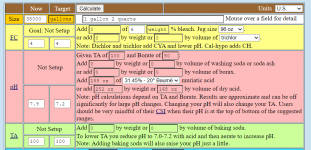

It would seem that there'd be some sort of curve to answer "How much?" the CYA buffering affects the overall pH change when adding acid?
PoolMath tells you the effect on pH from adding acid.
The TA and borate determine the effect on pH from acid additions.
The cyanurate is included in the TA number.
As you can see here, the borate doubles the amount of acid needed to move the pH from 7.9 to 7.2.
1÷(1+10^(9.15 – pH)) X 100 = borate percentage.
pH.....Borate.....Boric Acid.
7.2.....1.1%..........98.9%
7.4.....1.7%..........98.3%
7.6.....2.7%..........97.3%
7.8.....4.3...........95.7%
8.0.....6.6...........93.4%.

When lowering the pH from 8.0 to 7.2, the percentage of borate goes from 6.6% to 1.1%.
So, the buffering depends on how much borate needs to be converted into boric acid.
B(OH)4- + H+ --> B(OH)3 + H2O.
Every mole of borate that has to be converted from borate to boric acid requires 1 mole of hydrogen ions.
50 ppm boron in 100,000 liters is 5,000 grams of boron.
5,000 grams of boron is 462.4919 moles of boron or borate.
6.6% of 462.4919 is 30.52 moles.
1.1% of 462.4919 is 5.0874 moles.
So, we need to convert 25.43 moles of borate to boric acid, which will take 25.43 moles of hydrochloric acid.
25.43 moles of hydrogen chloride is 927.27 grams of hydrogen chloride.
20 baume contains 370.88 g HCl/liter.
927.27 kg/370.88 kg = 2.500 liters of HCl.
4.873 liters - 2.186 liters = 2.687 liters of 31.45% acid needed to convert the borate to boric acid.
