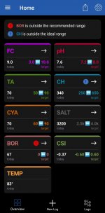

1) My CSI is -0.37 but modifying numbers in Pool Math, I don't see any way to get it close to 0 as even a pH of 8.0 only brings it to -0.20. If I increase CH to 450 and salt at 3600, it brings me to -0.27 with 7.6pH (-0.15 at 7.8pH). What do I do here?
2) TA is 70 even though I only ever increased this ONCE over three months ago when first balancing it, despite the insane amount of acid I put into this pool. How is that even possible?
It's BORATES DAY. Here's to hoping for the best because this is insane:
August 5th at 2pm pH was at 7.8. I added 6oz to bring it to 7.6. August 6th around 6pm it was 8.0!!! I added 12oz to bring it to 7.6 which I tested and confirmed at 9pm last night. Barely more than 12 hours later it was up to 7.8 so I added 8oz and tested to confirm it is now 7.6. This is simply RIDICULOUS.
Added 40lbs of Borates to bring the pool to 67. I read from some users who ran it slightly higher, and with my insane pH increase I'm really hoping to stabilize it a bit. I likely won't add anymore even next year unless the pH rise noticeably changes again, I figure I'll let it drift down on its own.
Test results before adding borates:
pH: 7.6
FC: 9.0
CC: 0.0
CYA: 70ish? I hate this test because I can ALWAYS see the dot in sunlight
CH: 340 -> 360 (added the last pound of the bag probably will go to about 360)
SALT: 3200 -> 3600 (added a 40lb bag to bring it to 3600)
TA: 70 (see question above)
CSI: -0.37 (pretty concerned about this)

What is your water temp? At 90F, your CSI would be -0.26. To get -0.37, your water temp has to be 77F. I cannot believe that your water is 77F this time of year.
83 today, have had tons of rain. Normally 83-87 lately. I'm just telling you what the pool math app says, see the attachment. You think it's wrong for some reason?
