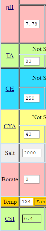

Salt cells scale up due to hydroxide created in the cell.
Heaters scale up due to high temperatures in the heat exchanger due to the thermal regulator blocking flow until the water is over 120 degrees.
If the cell is getting scale, the heater is probably getting scale.
Below, you can see the increase in CSI from 84 degrees to 134 degrees.
Maybe get PoolMath and track the CSI to keep it in the -0.3 to 0.0 range.
