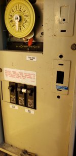

Looking at the pics, you can see where the wiring going to the pump and the wiring going to your light controller are all crammed together and touching each other.. This is not an issue for the electricity, but it does allow noise to jump from one wire to the other..
You can try to rearrange the wires to separate the power going to the light controller from the other wires. It may or may not help, the only way to know would be to try it.
I suspect that a simple noise filter will fix your problem as has been stated above.

I can't see everything going on int he box and where wires are going from the pics you posted. To fully understand the problem we have to understand where each wire runs to the pump and light which you are not showing us.
I agree with Jim that the wires crammed together create the possibility of cross coupled EMI or electromagnetic voltage induction sufficient for the electronics int he LED light to get confused about the control pulses.
The fix may be a noise filter. Or the fix may be to rewire and separate the electrical circuits for the pump and lights within the electrical box. Where the pump wiring comes into one side of the box and the light wiring comes into the other side of the electrical box. Each wiring connects directly to the CB and never crosses or comes near each other. A few inches of separation may be all it needs.
If you are not comfortable doing electrical work and need to hire an eletrician then having a noise filter installed would be the first thing to try. If that does nto work then the electrician needs to restructure the electrical box. Maybe use a larger box to give more seperation between circuits. And there may be other things going on with your wiring that we have not seen yet.

Show us pics of how the noise filter was installed.
So this is what it looks like now. Wanted to see if it fixed the issue before I mounted it inside and cleaned up the wires. Suggestions? Thanks alot guys!!!

No matter what I said before, the noise filter has to go on the wiring between the pump and the circuit breaker...
If you put the noise filter on the power line going to the light, it sees the relay switch as noise... :mrgreen: The relay or light controller quickly switches the power on and off to make the light change colors..
Reconnect the lights as they were before and make sure the lights still work as they should, then move the filter between the pump circuit breaker and the pump..

Read what I said in post #28 about cleaning up the wiring in the box and separating the pump wires from the light wires.
The wires are close enough that you are probably getting coupling from the pump wire noise into the wires coming out of the noise filter. The grey light wires run right past the pump electrical wires.
The only way to find out for sure what is going on is to connect an oscilloscope to the lines and see what noise and waveforms are on them. Otherwise you just have to keep on trying different things until you find one that works.
I don't think you will fix this until the light wires and pump wir4es are well separated.
Ok. Just tried that and I tried to separate the wires as best I could w the space thats there. Filter on pump line and light works exactly the way it did without the filter. Light comes on, flickers off then comes back on to a random color. This way didnt seem to affect anything. Filter on light line got rid of flicker but couldn't change color. Ugh.. lol...any other suggestions? Thanks so much!
