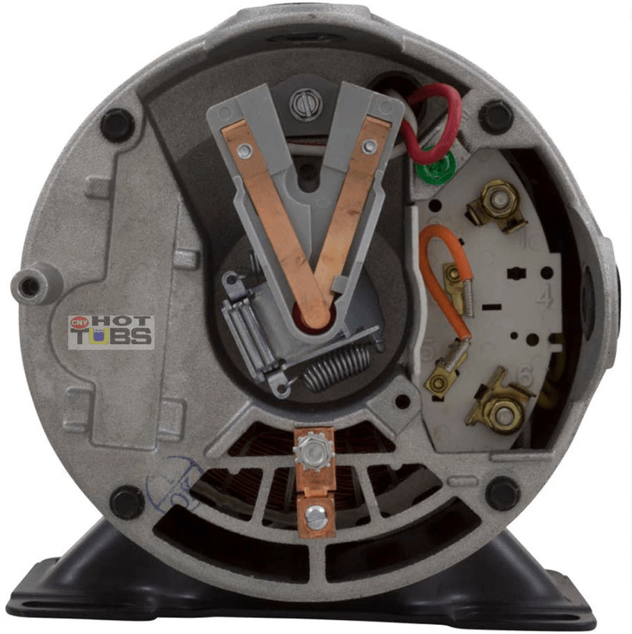

I have a pentair dynamo dynii N1 1.5hp pool pump that had a toggle switch installed on it but the wiring for the switch was corroded and causing issues so I pulled it off. I can seem to find a wiring diagram anywhere for this pump without the toggle switch. The inside cover says for wiring instructions without the switch to see the faceplate but the face plate only shows wiring with the switch. Anyone know how to wire this thing up to run without the switch?

I am not sure, but I think that you can just jump 3 to 5 as shown in this picture (orange wire) because it appears that that is all the switch was doing.
Note that I am not sure. So, you will have to decide if it is worth the risk to you.
a3664f73-8661-4986-aa5e-a3ada350ee2c-jpeg.343507
If it works, you would have to use an external switch to control the pump.
Verify all plans with a licensed electrician.
Only do what you are 100% sure about.
Do at your own risk.
