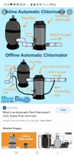

I have to ask. What do you mean by “automatic chlorinator”?
It gets hooked up to where the water comes out of the filter before going back into the pool and you add 5"ish chlorine tablets to it. So when the filter is on, the water gets chlorinated as it goes thru the filter. Ours is the inline hookup.

With 40 CYA the “Chlorinator” is not an immediate issue, but make sure you keep an eye on your CYA.
Do an Overnight Chlorine Loss Test. A CC of 1 without a clear explanation (like heavy bather load) can be an indication something is already going on.
BTW, your definition of opening early is way different than mine. :)
Ohio. April 15-30th.
BTW, we here at TFP really want people to understand what they are putting in their pools and why. The vast majority use liquid chlorine or have a salt water chlorine generator. We reserve the usage of pucks for when we might want to raise CYA levels, or we go on vacation and have no other way to chlorinate.
The primary reason is that pucks add CYA (cyanuric acid) to the pool. As you add more CYA to the pool, you need higher levels of FC to maintain a sanitizing level of HOCl. Read this: FC/CYA Levels. When your CYA level gets high enough (mine was 70 when I got my algae outbreak and was pool stored), you will get algae because the pucks can't add enough FC. Unfortunately, when you have high CYA, the ONLY way to get it out is to drain a portion of the pool and refill (or exchange some water).
For a liquid chlorine pool, we recommend between 40-50 for your CYA levels. If you use pucks on an ongoing basis, your CYA will get too high and you will have to exchange. Few here do that. But, they know it is going to happen.

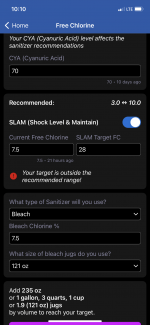

So I checked out the CYA/FC chart. At a CYA of 40, the FC should be at a minimum of 5, which is 5.5, so I don't need to add any liquid chlorine now? Correct? Just keep checking the FC and make sure it doesn't go below 5. The app used to show you the numbers for the SLAM process but it doesn't look like it's there now. Seems like the app changed a little? Do I need to upgrade to the premium to get the SLAM calculator?
No. The upgrade is for keeping track over time of your logs. BTW, it totally worth it.
On the dashboard click on FC And toggle the SLAM switch. It will give you the option to select the % of the LC and give you the amounts to add. Make sure your pool size is properly set.
