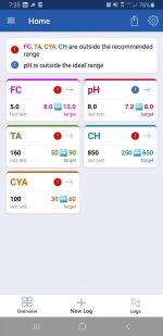

Wow, 70 ppm of TA.
I suspect that is the primary source of the issue. And you added acid at the same time? I would not go near that place again.
When you get your kit there is a good chance you may have to drain/exchange some water. Start determining where you will send several thousand gallons of water. Read Draining - Further Reading

Yeah so they had me dump all of that in at once. Then I waited 6 hours and then added the recommended 11 ounces of ph up and here's where we are. Trust me...I am only coming here from now on. I'm thinking a bad store test led me down this path.
On the upside...I ended up on TFP! I really appreciate the help!
I already have a submersible pump on the way and I have a place to drain it. I was prepping to exchange due to the high CYA (if that's even a legit reading).
Great. I am sure your CYA is high. Might be alot higher. So get ready for a large exchange.
Do not use pH UP in the future, that is sodium bisulfate. The sulfate stays in the water and degrades plaster and destroys metal.
