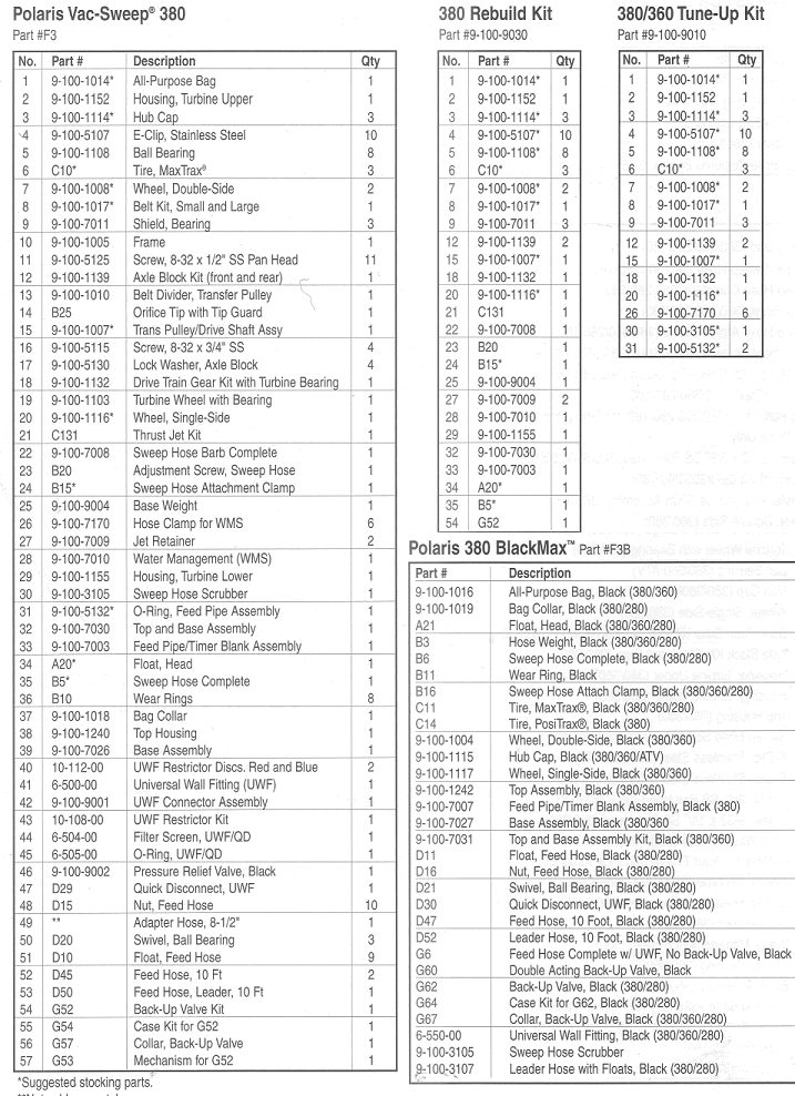

If the plastic housing cracked the frame may have cracked. You need to rescue the Polaris and give it a through examination and maybe some disassembly. See how easily the wheels turn.
The water pressure powering the Polaris has little torque and any friction in the moving parts will stop it. See the parts diagram below. The water flows though the feed hose (part 33) and into a spider of hoses called the Water Management System (part 28) that directs the water to a turbine wheel (part 19) to power the wheels and jets to create the cleaning suction.
How old is the Polaris? While all parts are available if the housing is cracked it may be towards the end of its useful life.

Two 10-foot sections of feed hose with floats have arrived. Part 9-100-3104. I’ve looked through the diagram on configuration provided here (TL-855 Rev 8) and same diagram came with part. In the diagram, I see leader hose and feed hose. Are these adjectives to describe the function of each length of hose (leader below water line and feed is floating) OR are these actual different types of hose?
I’ve searched all through Leslie‘s, I’ve looked through pool supply world and PolarisPool.com and I cannot find two different parts. I’ve even looked through videos that show tips for assembling the hose which does describe a different type of hose. However these videos are 5 and 7 years old. So I wonder if the newer part has same hose for both functions, i.e. feed and lead.
I’m so ready to get going. ;) but hung up on this point ;/ Plan to call zodiac pool systems in the AM.
CarefreeTee
Active member
Aug 9, 2020
35
Carefree AZ
10000
Fiberglass
Ugh! Found it... part 9-100-3108 ;(((
