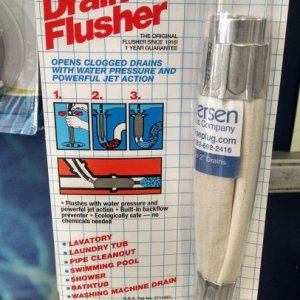

Just to answer your reply about not knowing how to push water backwards .... there's a couple ways. Insert a garden hose into the pump strainer pot where water enters from suction, wrap a rag around the hose in an effort to try and create a seal, then push water back towards the skimmer. Some people will grab a Drain King bladder or something like below to assist. Even though you tried various suction options, it doesn't take much to block flow.
