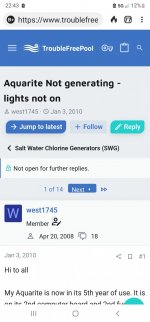

Hello,
I was having same problem and searched and came across a conversation thread from 2010 on this forum/site. It seems many people have the same problem (no flow light constant and it is not related to a bad flow switch or any other reason they could find when troubleshooting)- and it is the "thermistor" (a little round black part) on the main computer board that is very cheap and not hard to replace and resolder. It is much cheaper to do this than to replace the entire board.
I could not get the part I wanted from digikey but did find on Amazon for cheap and quick delivery.
I can give link if you want for the part and also for a you tube video on how to remove the PCB and another video to show you how to replace / resolder the thermistor.
For now, attached is a picture of the start of the thread from this forum in 2010. You'll have to search for the thread as i could not attach a link.
Read through it- was very helpful to me- was so thankful to have stumbled on it.

Here is the link to the thread from this forum/site in 2010 that was very helpful about the thermistor. Hope it opens for you.
