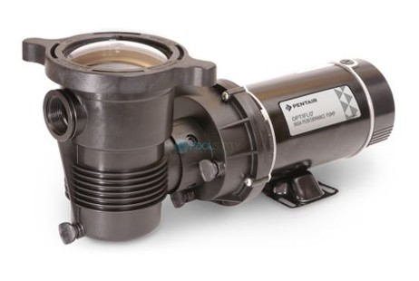

I’m seeing what you mean on the lack of info. After a few hours I think I can piece together a 150sf filter and a two speed, 1hp pump with vertical discharge as follows (a little more than I thought it would cost but not too much):

That filter (and most cartridge filters I’ve seen) appears to have the input near the bottom. A horizontal discharge pump is a more natural connection. If you do get the vertical discharge pump you’ll just have some extra bends in your plumbing.
Ah. I could very easily be wrong here and have misunderstood the connections... I was thinking on the Clean and Clear RP line, the input was on the side, in the middle of the unit so vertical would be the easiest connection. However, if this is actually the output ...😬
I also saw this (which is not even connected to this specific filter, but is a filter with two connection: one on the bottom and one in the middle) which led me to assume (yes I know😉) that the inout would be in the middle:
