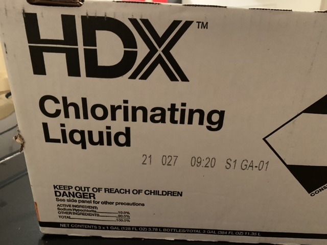

What area in the store do you find this? I looked all over my local HD... May have to look closer next time.
Ask a manager. Check the HD app and it will tell you if they have stock in the store. Sometimes it is not on the floor and I have to ask a manager and show them the app says they have stock and they have to get it down from a shelf.
In this market for some reason that's one item that they almost never show how many are in stock on the app or online. I'm not sure why, maybe it's just because there's such infrequent stock from whatever manufacturer coming in.
Like mentioned above, local stores here when they have it, stock it outside back in the back of the garden center by the rest of the pool stuff and fences / trellises, etc.

Thanks for everyone's help so far! (I was able to find the liquid chlorine at a different HD last night)
