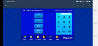

2. Is there a default that I should set my aquapure on until kit arrives? It is currently set at 0.

You can do some math on the cell’s FC production or just set it at 50% and run the pool for 10 hours per day. Check FC in the morning and after the run to see how much it went up or down and adjust up or down accordingly. There are more things you can think about regarding pump run time but they aren’t critical to get you started.

Just got in today for the first time we have done so much work finally able to enjoy it together. I set the Aquapure for 50% at about 1pm still says 0% on @ 8:15pm anything else I need to do? I have to troubleshoot one of the (4) jets but overall I really enjoyed the pool after all day in basketball gym with kids. Thanks all sorry for all the question but really enjoying the interaction and learning.

    • It was at 0% at main control/aqualink box evern though 50% at app

Just took my panel apart ribbon cable was a bit loose but aquapure still wasn't working from iAqualink. I placed in service mode I was able to turn cell on and set chlorination @50%.
Prior I could also get to water temp from panel by hitting the down icon. Any ideas my new family on getting this operation working via Aqualink.
