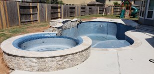

We have pool filled! Started yesterday at 3:15pm and ended with about 17,400 gallons (after subtracting 300 for typical water consumption) at 1PM today, so 22 hours later.
From excavation in mid-April to pool fill mid August, it took us just under 4 months to finish. But we signed in mid January, lol.
Now, onto start up. My PB said they'll have someone out next week for official startup but came by today to briefly explain what I should do. He said to cycle the filtering between pool and spa manually for now and just brush all the dirt or debris towards the drains.
I'll read through the start up instructions posted earlier by Kim and see what I need to do until then.
