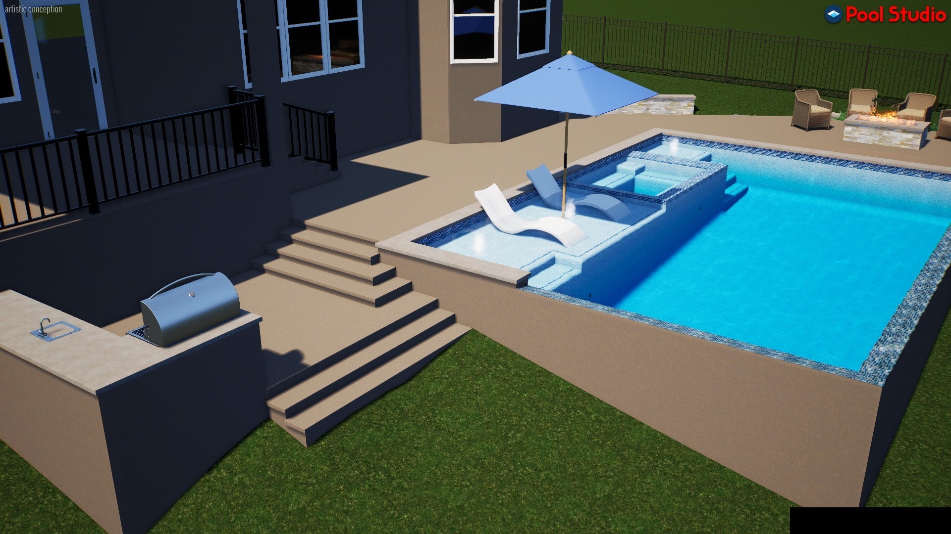

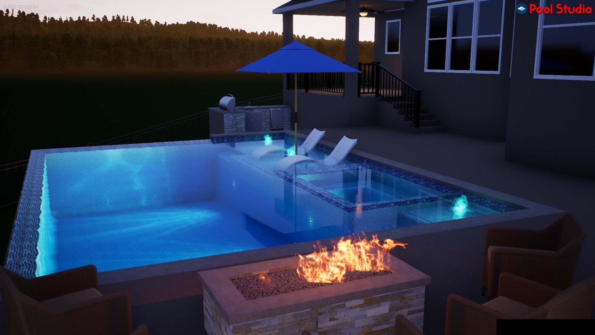

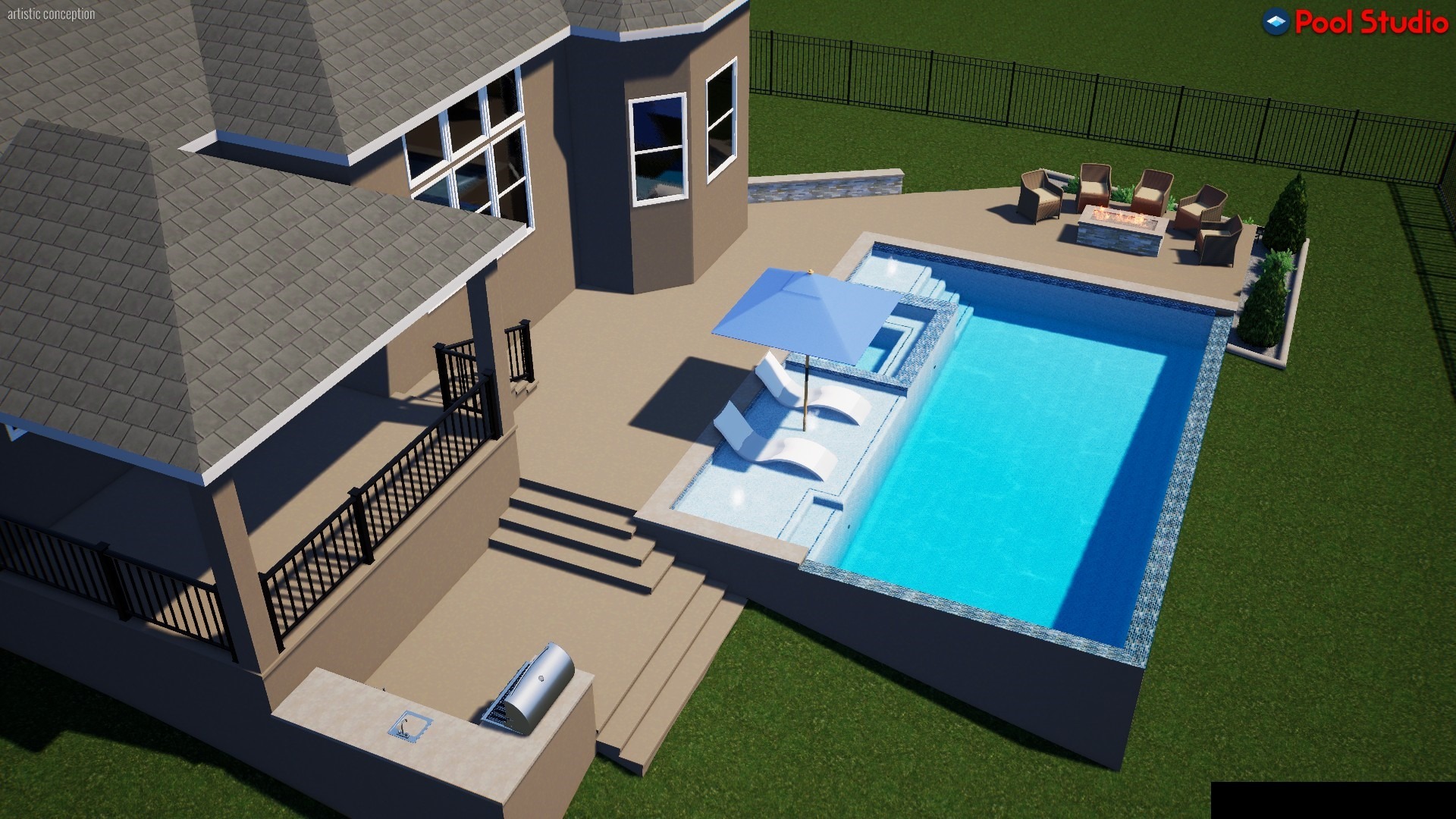

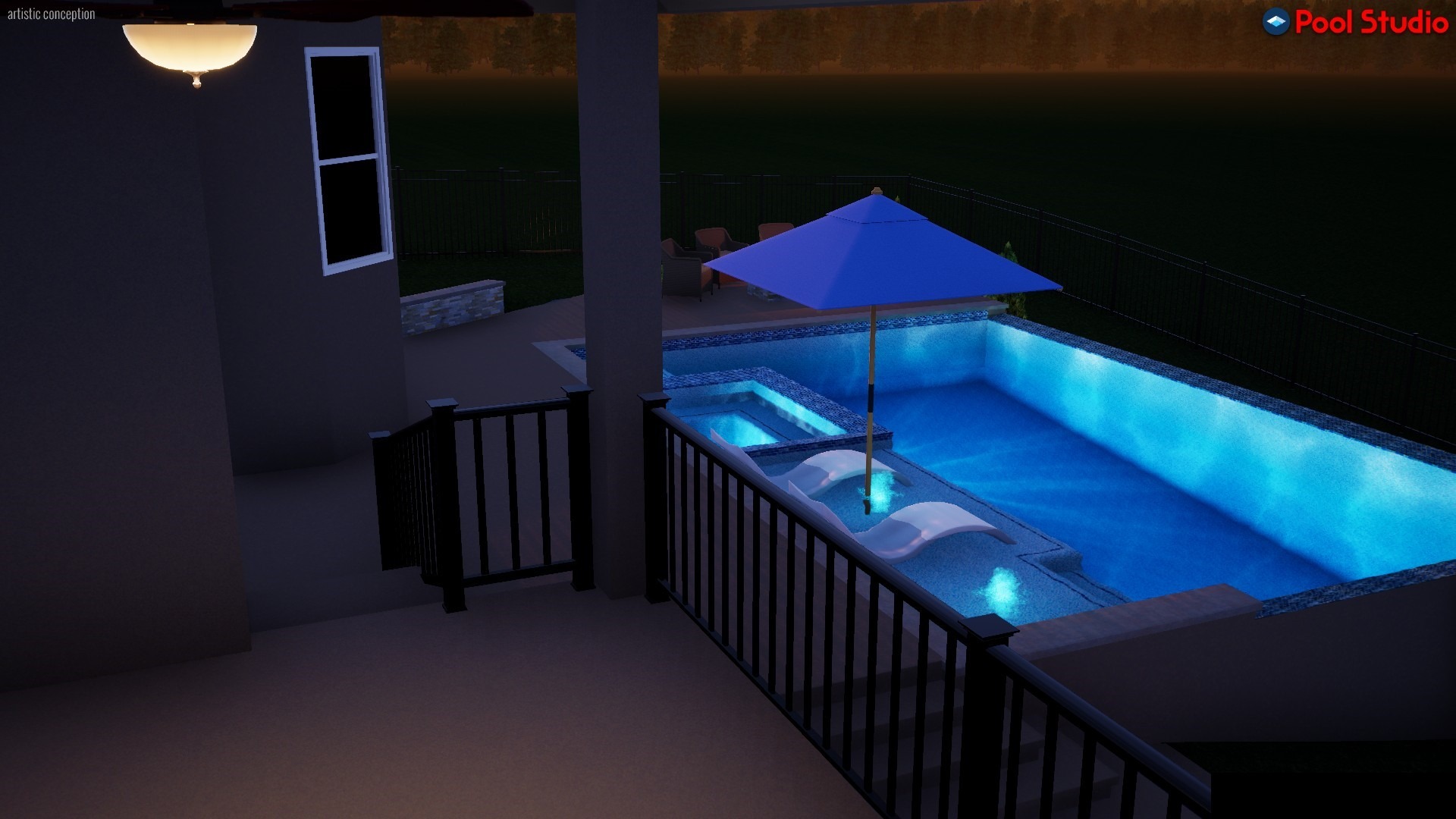

I started a thread back in May (Finalizing PB Quoting and Equipment List, Austin, TX) to get your inputs to help us finalize our build quotes. Well dig day has finally arrived and my poor yard is a disaster zone, But for the better :)
Pool Info and Timeline so far below. I will keep posting pictures and status periodically. Let the fun begin
Included is a pool, spa, tanning ledge, fire pit, outdoor kitchen and of course some decking
Total pool/spa size: 21x30ft
Total combined gallons: 14,842
Gunite
  • 1/2in Grade 60 Steel Rebar on 10in centers in both directions
  • Rated to 4000PSI
  • 12in Bond Beam
  • 8-10in Walls/Floor
Pool: 3.5 to 6 feet deep & 14292gallons
  • Faux Infinity Edge on 2 sides
  • Pebble Sheen
  • 5 Directional Returns, Looped for even pressure
  • 2 Independently plumbed Pentair skimmers (model: 506300)
  • 1 Eclipse Drains
Spa: 6x8 feet & 550Gallons
  • 2 1/2in PVC pipe
  • 6 Spa Jets
  • 1.5in Dedicated air line
  • 1 Eclipse Drains
Tanning Ledge: Depth of 6inches, I don’t have exact dimension but guessing about 6x16ft
  • 2 Bubblers(listed below, +1 at steps)
  • 2 Umbrella mounts
Equipment: Updated list with model numbers
  • Decking – Concrete with Koolcote, 4 drains
  • Pentair Intellitouch i8PS (model: 521904) Unfortunatly PB didnt bring the one with the built in IC power supply so I have an external IC PS also (model: 520556)
  • Pentair Intelliflo 3HP VSF (model: 011056) - was planned to be a VS but they brought a VSF
  • Pentair Whisper Flow 1.1SFHP DOE Compliant Single Speed (model: 015583) - To run bubblers
  • Pentair 400k BTU Heater (model: 460736)
  • Pentair Cartridge Filter 520sq (model: 160332)
  • Pentair Intellichlor IC-40 (model: 520555)
  • Pentair Inline Chlorinator (model: 320)
  • Silencer spa blower (model: 6310241)
  • Bubblers – 3 ColorVision Bubblers (model: 580037)
  • Autofill with backflow preventer connected to hose bib/spigot (MP Industries water level control)
