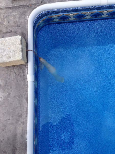

Then while that is mixing, measure out CYA. About 8 lbs. And put it in using the sock method described in Recommended Pool Chemicals - Trouble Free Pool
In the skimmer or like this

Wow, what a difference 8 instead of 9 is. You were right on target with a quart. Added that in front of return, and now looking for a knee hi to use for stabilizer. I threw them out when i retired. I have brand new trouser socks (black tho) that are polyester and stretchy like panty hose. Can I use those or will the black run and ruin my new resurface?
jetskierg
Jul 5, 2019
56
Phoenix, Arizona
Update - Found a white tube sock and tied it off so it hangs in front of return. I could only fit about 1.5 lbs in there so i have a long way to go to get 8 lbs in. Anyone hang multiple socks at same time? When do i test again? When does chlorine go in? i'm concerned because it is 107 degrees in the shade here pretty much everyday now. thx

You can set sock number two in the skimmer if you have one. Use the dress sock if you want. CYA is a very weak acid, It wont dissolve it.
