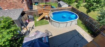

Fast forward to early June and here we are.
All systems go
The install went well. The hard part was definitely the base. Really important that its level and solid. Obviously time will tell how well my base holds up but Im confident in my work..
Funny the pool company wanted $2500 for install of the pool. Thought to my self that's a pretty good price until they mentioned that didn't include the base...that's when I looked at them with disgust and said its alright I got this guys .. Ill do it my self.. thanks for offer...lol
I also knew that if any thing went wrong with the pool for a next few years they would instantly blame the "base' as the root of all evil if I paid them for the install....
The level is bang on any and every which way.. I think I bummed up the liner a little and its approximately 8 inches out of orientation but it stretch into place nicely - its only some thing I notice.. Again very poor instructions from liner manufacturer and pool company. I noticed there was a lot of guess work through the entire process due to inadequate instructions. I now can see how a round pool installation is much easier and less pone to mistakes than an Oval pool.
I was shocked as to how the Styrofoam bottom is soo soft on your feet when in the pool. I was also surprised as to how quickly the pool gets up 84 degrees without a heater and my neighbors were also shocked that have in grounds. .lol
I did buy a a gas heater but its not yet plumbed in or fed a gas supply.. coming soon
I used EPS styro foam ( the cheaper stuff) and it seems to be working out good or rather my taping job is holding very well.
I'm in the process of figuring out my chlorination schedule and amounts, almost there now . Using liquid chlorine only...
Anyway there you have it folks. Hope this can help some out with their installation.
