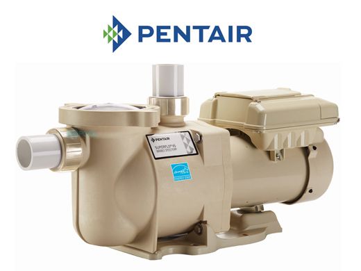

My Pentair Superflo VS (model 342000, in service since 2014) died 2 hours after pool opening. It was running fine and just cut out. No LED lights are on, but the circuit breaker was not tripped, so the problem must lie in the pump. Perhaps wiring in the control module is fried (trying to figure this out), but I assume the motor is dead and I can't figure out the replacment motor for this. This is an older model Superflo VS without the LCD screen, and the parts available on line aren't so clear to me. The motor model number reads M48AA95A03, the manual lists a replacement part called motor/drive part nr. 358020Z . Doing a google search for either of these numbers comes up with nothing that looks the same so if someone can help me figure out what part I need, I would be grateful.
(UPDATED) It looks to me like Pentair has abandoned anything to do with this model. Its completely absent from their website, and I described how none of the parts I found on line look the same, they look like they all belong to the updated model, which I dont think fits this one.
