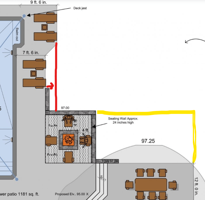

Overall plan:
Zoomed in plan
For reference, the light gray circular outline is the existing patio. The knee wall is added to facilitate the slope dropoff to the pool which sits 2' lower than upper patio and at driveway elevation, and provide seating around fire pit.
One of my concerns is the smaller size of the new "upper patio". Feels like it could get tight after seating/grill. Also I need more privacy from driveway (can see directly into pool).

Why can’t you move the pool more back on your property to give more deck space and to the right to get it away from the driveway?
You have a deer problem in your area? I have my pool double fenced. Deer get over the street side fence but not over the pool fence.
How much privacy do you want around the pool? How much room for layers of privacy shrubbery around the pool? You have the room if you place the pool right.
You need a larger pool equipment pad.

The location of the pool is meant to optimize the following:
- Maintain as much of a continuous yard as possible (ie, putting the pool in center of property, or east/west would have made more of the yard segmented)
- Have it easily visible from kitchen which is just inside the back staircase (putting it on other side of property would have made that difficult)
- try to keep the size of the deck manageable for cost purposes. Bigger deck = bigger $$.
Not sure about deers. Just moved into the house.
Privacy is important but we already have a lot of privacy due to my neighbors existing fences/trees on either side, and a rock wall/trees in the back. I’ll need to add privacy on the driveway side, especially for the gate itself since it will be see-through aluminum. I don’t want the pool visible from the driveway. There should be enough room for whatever solution works best.
I hear you on the equipment pad, but there’s a good amount of space available there. This seems like the ideal location, next to the existing AC units (so I can hide it all together) and close to the house for easy electrical/gas runs. Not sure where else I can put it that makes sense.

I have three thoughts on the pool environment. I do understand that you are trying to keep the deck size in check, but I know at our house, we have enough room for numerous picnic tables on the house deck and the pool deck and it comes in handy. So I appreciate space. It tends to evaporate when you have a family party or kids sports team party, etc. My suggestions are:
1) Move the knee wall back to the red line and expand deck to it. This will create much more usable space along that side of the pool. As it is, your chaise lounges will hardly leave room to walk comfortably by the pool when extended and people will be getting splashed while sitting in them. I'd also include some outlets in the knee wall near the fire pit and also by the red line wall, assuming it's far enough from the pool for code.
2) Add space to your upper deck for another table area or four Adirondacks around a coffee table. This space will come in handy for parties.
3) You currently have no way to drive a vehicle into the back yard for whatever reason. I would recommend widening your opening on the right side to 8 or 10'. Perhaps one gate never gets opened but it's there if you need it.

Agree with the above 7.5 ft is not enough to use for lounge seats. A few feet there to 10+ is money well spent. You are scrapping all the existing patio? Why not use existing patio and tie off of that to save some decking money? I generally dont like to instal long pools lengthwise away from house but your yard is big enough and you have the room by the pics.

Thanks I'll discuss expanding the patio with my PB. Regarding the gate on the opposite side, it is actually going to be 10' double gate (PB wrote the wrong size on his plan).
Yes I'm scrapping the existing patio only because I don't love the sand/tan color. Prefer more of a gray look and want the old patio to match the new. I wonder if replacing an existing patio (where the base is already prepared) is cheaper than the starting from scratch.
