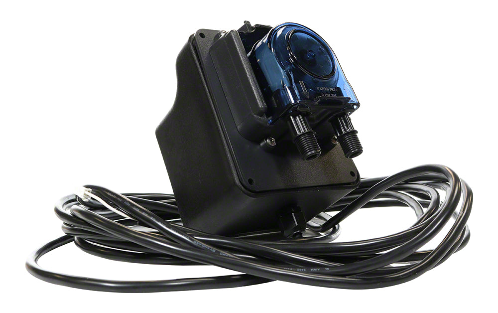

If the IpH's pump isn't a Stenner, it is virtually identical to one, so you're not gaining or losing anything there.
I don't remember the changeover date but the newer IpH pumps are Stenner Econ pumps. So can buy parts from Stenner instead of Pentair and save a few bucks.
Good to know, I figured as much. So all I need now to complete my IntellipH Doctoral Thesis, "Everything You Never Ask To Know About an IntellipH," is a price comparison between an IpH tank and pump (without controller) and a comparable Stenner setup.
Pentair
The tank is on sale now at PoolSupply for $279.00
The pump looks to be about $173 from PoolWeb.
So $452 total.
The PoolGuyStore lists a new IntellipH with controller for $519.
